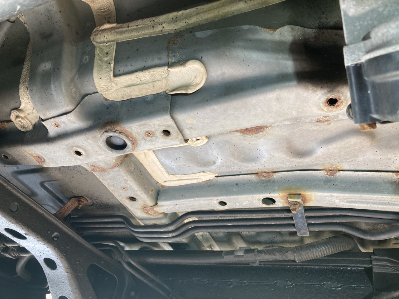

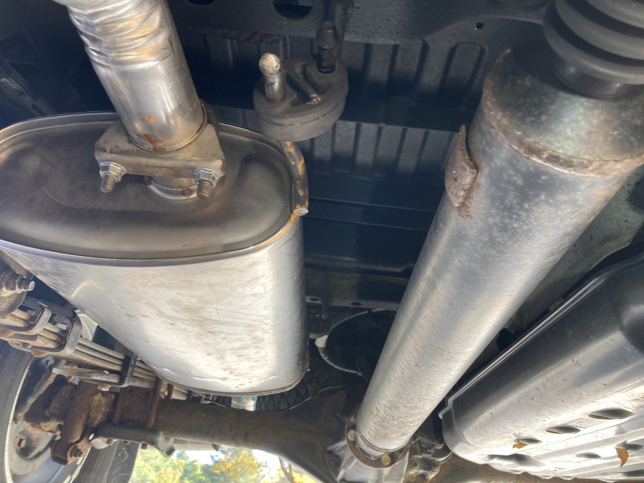

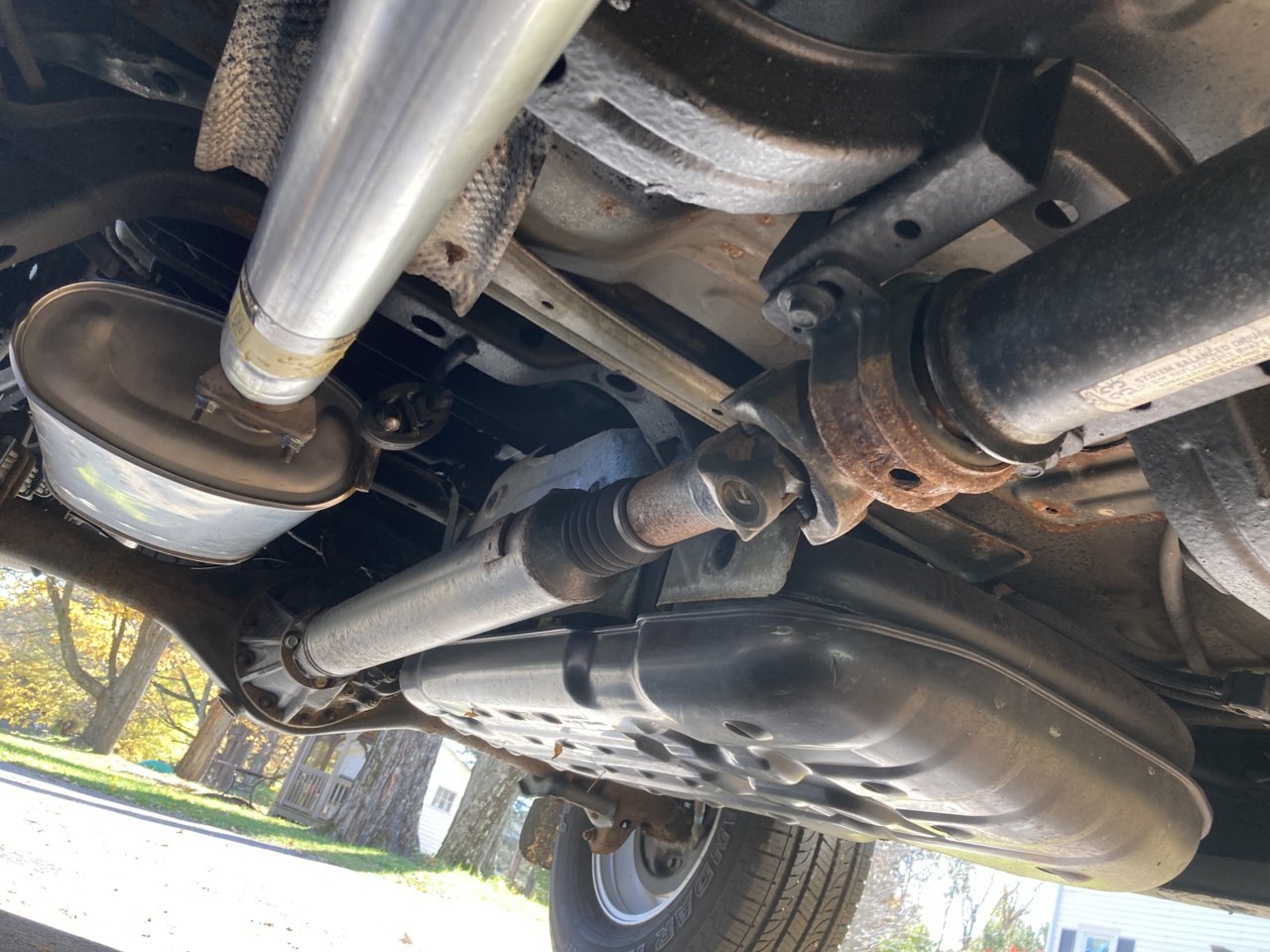

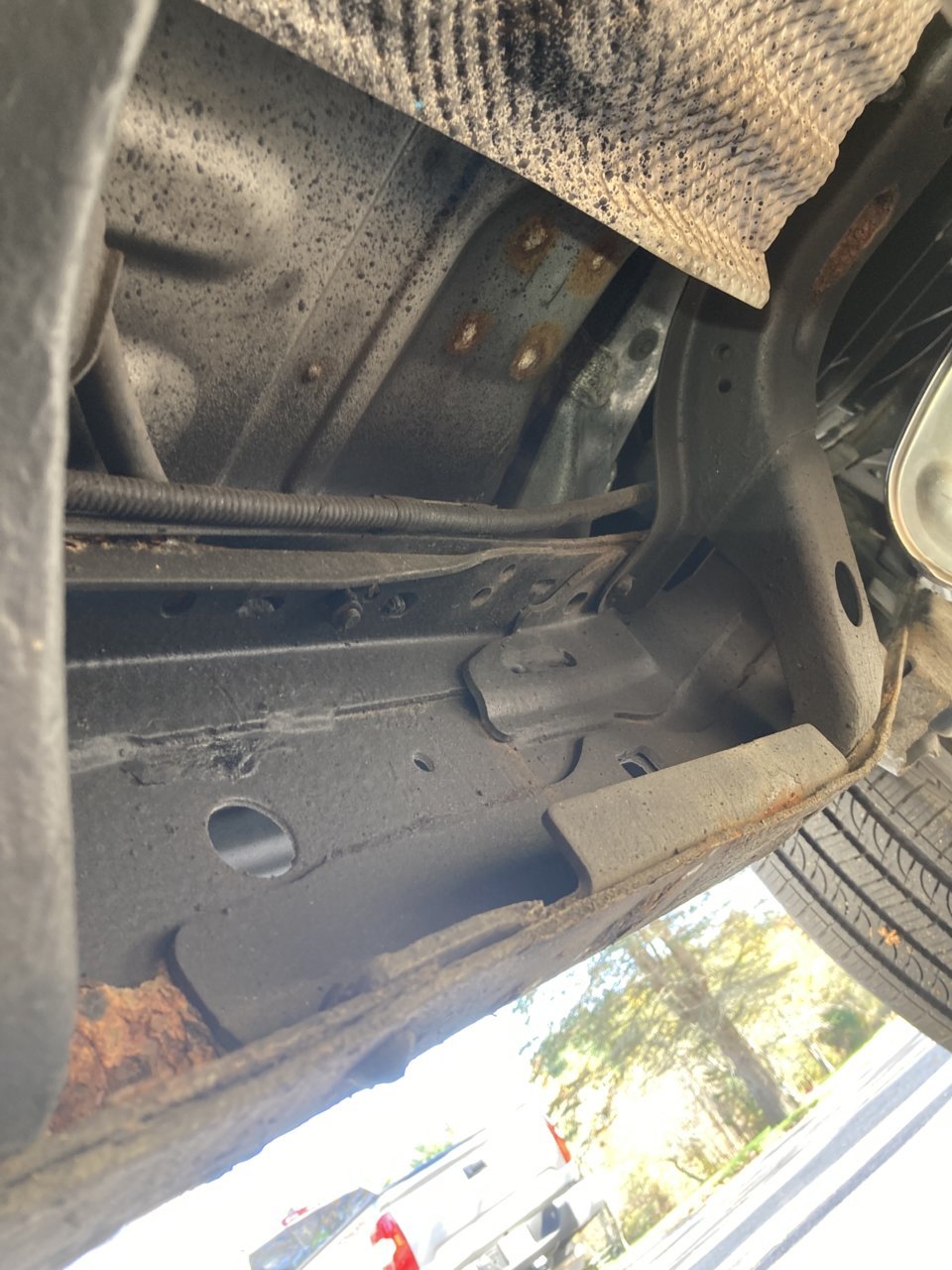

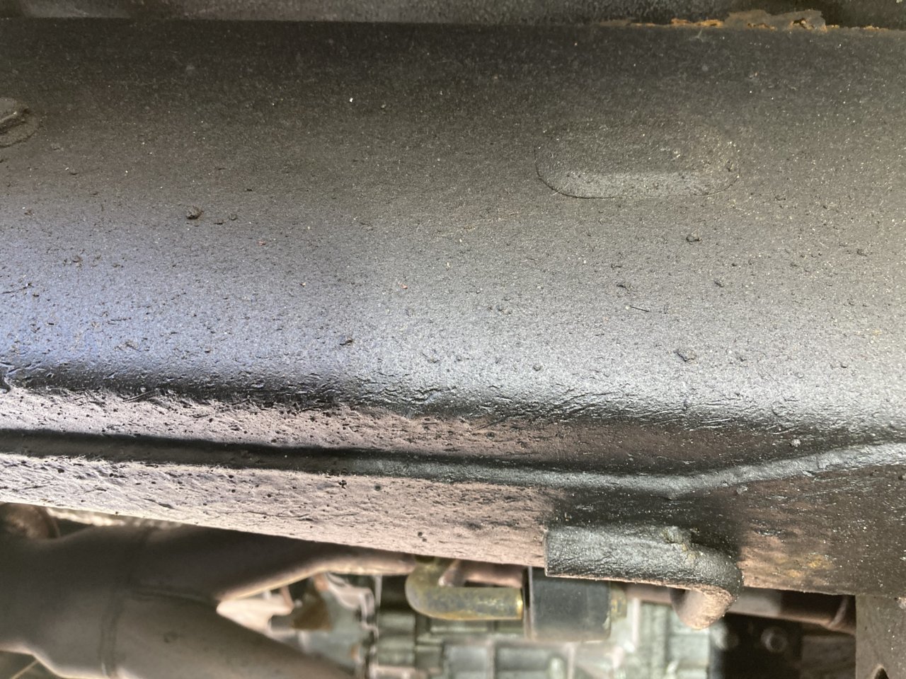

Opinions on the condition of this original 09 frame
Discussion in '2nd Gen. Tacomas (2005-2015)' started by Chris2009, Oct 29, 2021.
  1. Oct 29, 2021 at 12:31 PM
    Chris2009
    Chris2009 [OP] Well-Known Member
    Oct 29, 2021
    #380833
    262
    Massachusetts
    2013 Reg Cab 4x4

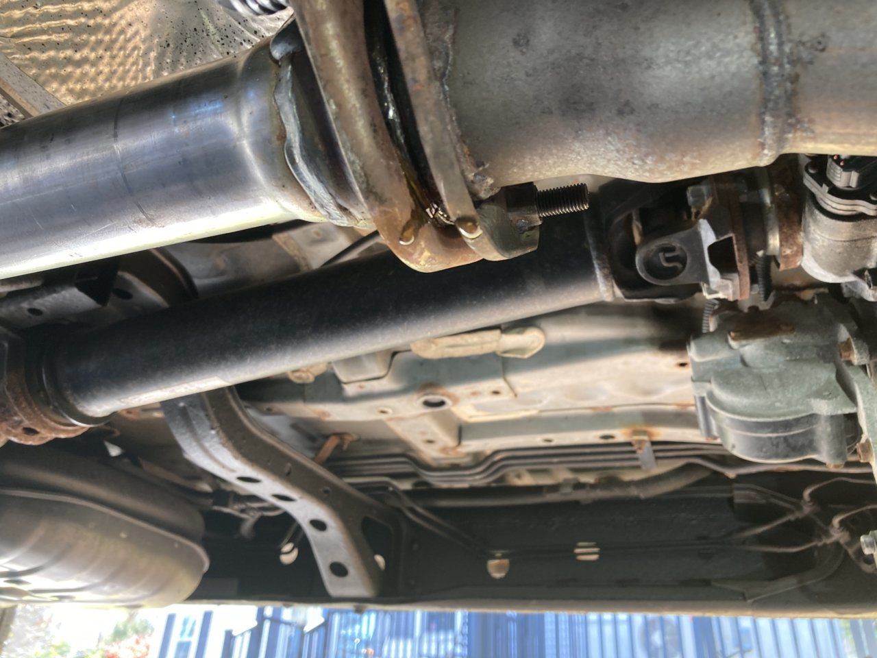

    7CB7C363-C234-452A-BE30-2E8C0E4A79B8.jpg 48593556-436F-4691-98E1-6FA13F09B969.jpg D102586B-E2A9-411C-BA88-8ACA7271B008.jpg 8CD52738-7E21-4947-8A92-7FE45386D4D8.jpg 6562906D-C68E-4DDD-91C3-E5B28335A87F.jpg 6562906D-C68E-4DDD-91C3-E5B28335A87F.jpg 90621140-5D06-4AF7-8E54-7949379F69C1.jpg 90621140-5D06-4AF7-8E54-7949379F69C1.jpg 46D948D6-41A7-4419-87EA-EDF183209864.jpg 7CB7C363-C234-452A-BE30-2E8C0E4A79B8.jpg 48593556-436F-4691-98E1-6FA13F09B969.jpg Hi Tacoma gurus, I’m wondering if you can give me you opinions on the condition of this original 2009 Taco frame….I’m considering purchasing the truck but the frame issues have made me leery of the 05-09 models that are now out of warranty.what do you think?

    This truck received the Toyota undercoating according to the seller.

    Hard to tell from just the pics but I can say that it's close to what my 09 looks like. Toyota inspected my frame back when they started their recalls and said that there were no holes. Just in the last few months I paid to have it Ziebart undercoated and that was a mistake. Not necessarily because it was Ziebart but because of the local shop that did it. I could have down a better job myself even without a lift.

    Looks like they did the same to yours as they did to mine undercoated over rust. Mine still rusted through and needed a new frame. Some of those pics it's hard to tell. But judging by the rust on some of the other components like the rear, under body, brackets and such it's probably pretty bad.

    You need to look up in the frame rails toward the front of the truck. Also, look at the spare tire carrier, if it's heavily rusted than you can bet the inside channels of the frame are too.

    Try taking pictures of the frame rails and posting those.The black undercoating is making the frame too dark to photograph next to the lighter colored floor pan, mufflers, etc. First impression is it has had an undercoating cover up job and it’s probably rotted.

    Thank you, fella’s… I think I’m gonna let this one pass. Too bad, relatively low mileage, clean topside, V6 Sr5 TRD package.

    Boxed areas by the cats. They tend to rot from the inside out.

    You got lucky not touching that truck. You can tell it's rotting from the inside. Good for you doing your homework
