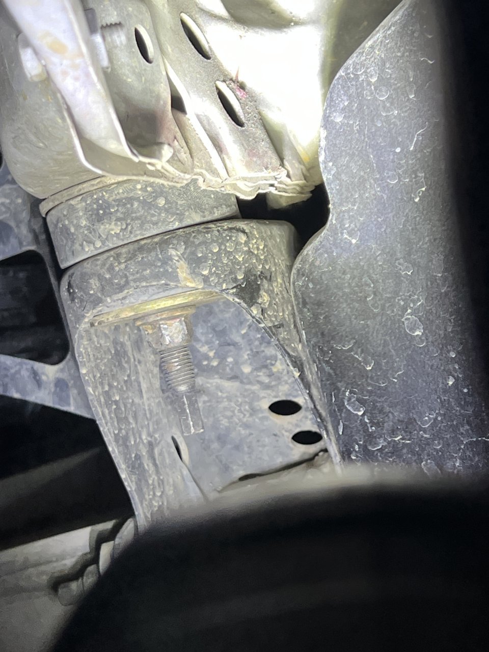

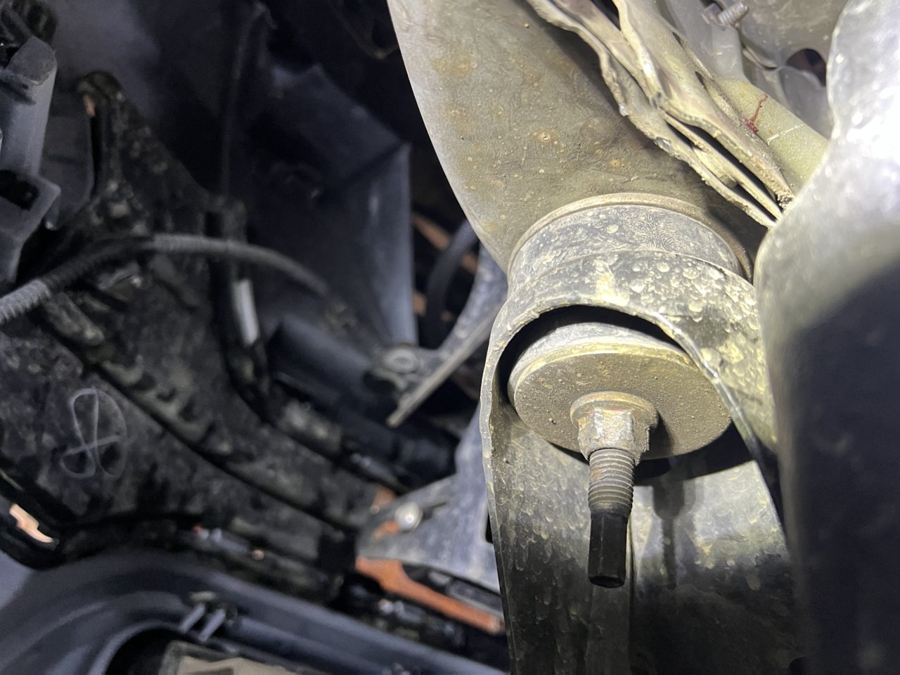

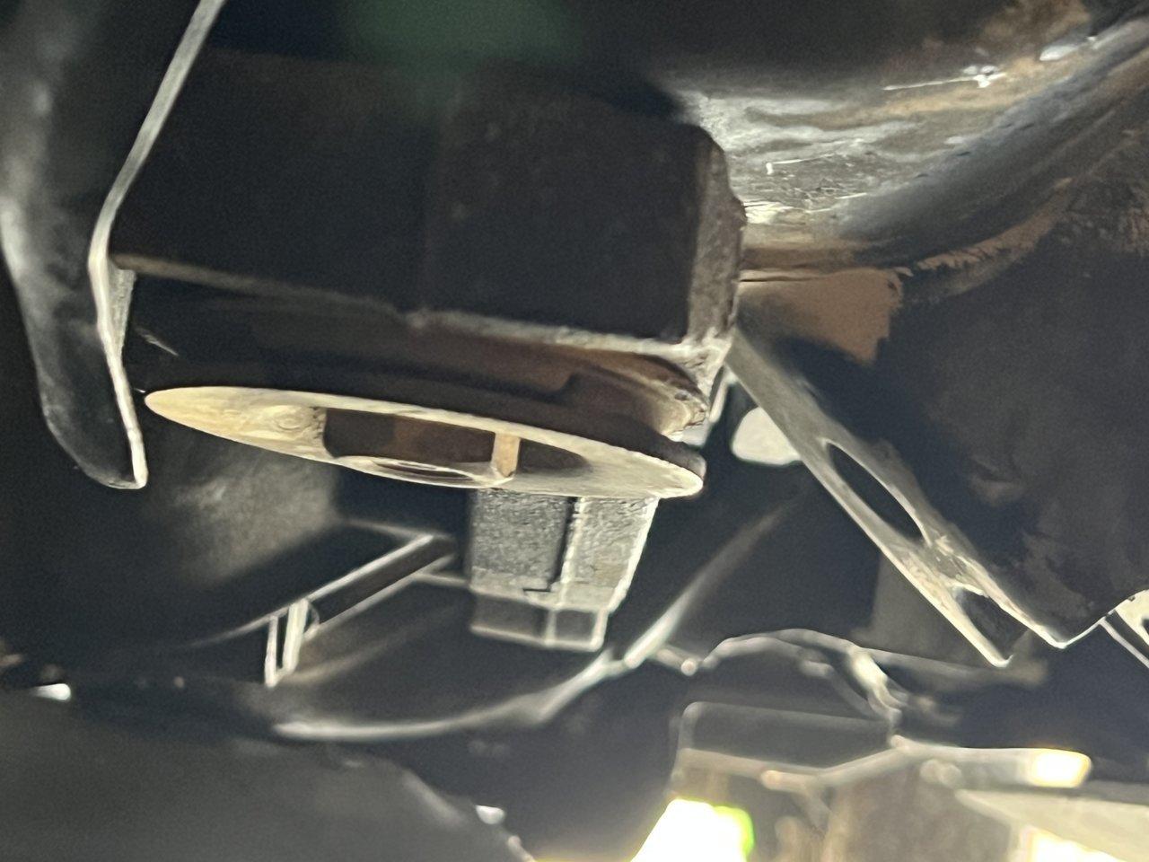

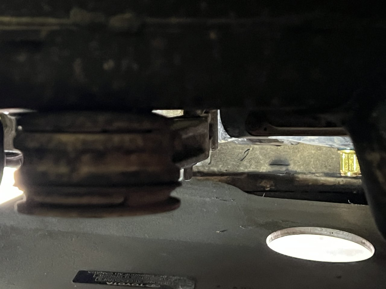

    So I see lots of ppl talk about cab mount bushings and radiator bushings going out way more often than the front differential support arms bushings. I’ve taken a few pics of my radiator support bushings and to me they look very good and tbh I’m surprised bc the truck has 150k miles on it now. On the other hand My front diff bushings look toasted imo. I don’t hear of these being replaced nearly as often but I know if the differential is moving around that could cause some premature wear on cv axles.
    Front differential support bushing
    IMG_3810.jpg IMG_3811.jpg Radiator support bushings belowIMG_3808.jpg IMG_3807.jpg

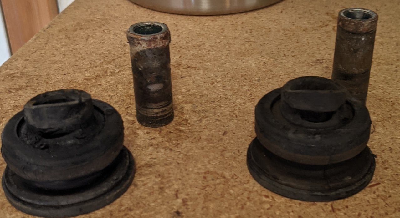

    The rad support / front body mount ones are the main issue, but the problem is not externally visible. Pic in a second.
    I know folks that have had front body mounts making noise at less than 1k. I highly recommend the Rogue Offroad poly kit:
    https://rogue-offroad.com/ROGUEENERGY-Body-Mount-Set_p_19366.html
    At about 55k:

    Your radiator support bushings look great because they aren't factory. They're aftermarket Energy Suspension polyurethane bushings...
    The front diff mount bushings aren't known to be a problem. If anything the bolt can tear itself from the frame, but the rubber bushings are ok...

    What is toasted about your diff bushings? They look normal in the pictures.
