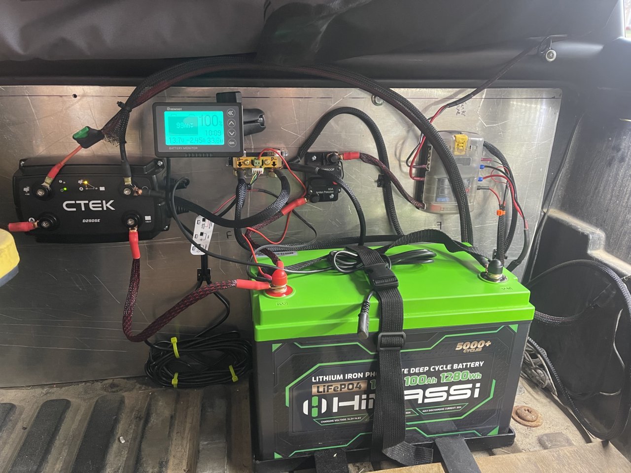

    Definitely second the LiPo battery. I have a chinese one for 8 months now, and no issues. It weighs 23lbs. Running bed lights, and an Iceco VL60 ProS fridge. This is what my setup looks like:
    Brex69[OP] likes this.

    I’m just getting ideas, product info and prices in regards to adding a auxiliary battery. Gunna try a few camp trips with the EcoFlow then go from theres. Thanks for the info/pic
