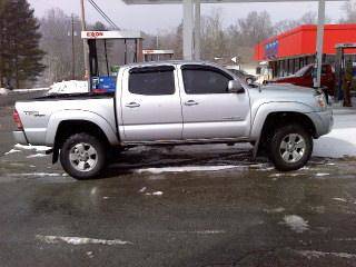

    throw some up***
    here are the 265s[​IMG]
    265s...

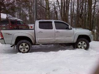

    and 285s....[​IMG]
    285s...

    since those larger tires were 11.5" wide and I used the stock Alloy wheels (7.5" wide, 5.5"backspace) I had to use 1/4" wheel spacers to fit the tires. The tires still rubbed just a tiny bit on the UCA but nothing to worry about...
