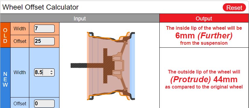

    That’s awesome! Thanks so much
    on the offsets….I have spacers installed now, with the OEM stock wheels. I assume the 0 offset is basically like stock. But for the -10 offset, does that imply I’d remove the spacers?

    The oem wheels are more than likely +15 or +30 offset. If you run a wheel that has zero or -10 etc I wouldn’t run the wheel spacer.

    Does the 8.5 imply 8.5” wide?

    Yes

    @JayTac it is best to find a wheel that achieves the look you want without having to use extra parts (spacers). A zero offset would be most typical for aftermarket.
    No spacer and more poke. Method, Nomad, KMC, Fuel, Raceline to name a few. Hope this helps.
