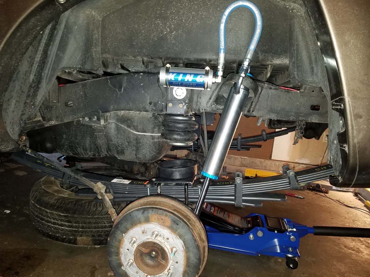

    I have a dclb with cap and prinsu, my air compressor, and hilift sit in the bed. And i am eventually going to hc bumper. So i have extra weight daily. I tow often, travel trailers and boats.
    I went with dakars with upper over load removed and added ride rites with day star cradles. Which allows for droop. Best of both worlds in my opinion.
    Picture is before removing the overload and adding shims.
    Catfish21 likes this.
