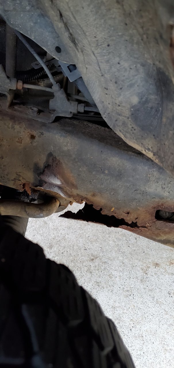

    Was looking under my '02 today and found these areas.
    This is driver's rear wheel well.
    Front drivers wheel well.
    Is it repairable? Or should I just start a part out thread?

    You can get replacement frame sections and have someone weld them in. @Black DOG Lila has a link :thumbsup:

    Jesus Christ. That’s immediately stop driving kind of shit. It probably can be fixed with Many thousands of dollars, but unless you are ready and willing to do a frame swap, I’d start parting it out

    You're gonna need to do something.
    You have a couple of frame failures. These will only get worse. Eventually, the frame will collapse.

    A full width frame crack like that makes “eventually” pretty optimistic :rofl:

    Something is holding it together. That something will break......its a matter of when, not if.

    Start a part out man! See if you can get a non-rust belt vehicle. Did you inspect before you bought it? That seems so long ago not sure if this just came about or was already there! I’d almost be reluctant to drive it!

    1) Do you have money?
    2) Can you weld?
    If the answer to either one is yes... well, realistically, you need to check the complete frame, how are the spring hangers and shock mounts? Start tapping with a hammer to check the extent of the internal unseen rust.

    I wouldn’t lay under this one to tap on it, kids may not have a daddy for thanksgiving.

    There are ways to repair.....short of parting out.
    Suggest to find a frame shop. Talk to them with the pictures. If they can make the repair, then have the truck towed to them for a QUOTE before work is started.

    holly hell, is this the first time you've looked at the frame of your truck in, like, forever? That shit doesn't happen over night. And all of that is easily visible without even having to bend over or get underneath it. Absolutely scary you drove that thing.
    Sure, part out all the non rusty bits. Body panels (maybe), interior, wheels/tires. More than likely everything else metal is just as rusty and not worth trying to remove. Engine is a maybe. Even if it runs okay, guaranteed all the bolts are rusted shut.
    Other option is a frame swap. But you'll end up needing to replace all the other rusty bits as well, and that usually ends up being a lot of work and money.
    I wouldn't bother with frame plates, especially on that front hole. There's nothing left to weld to!
