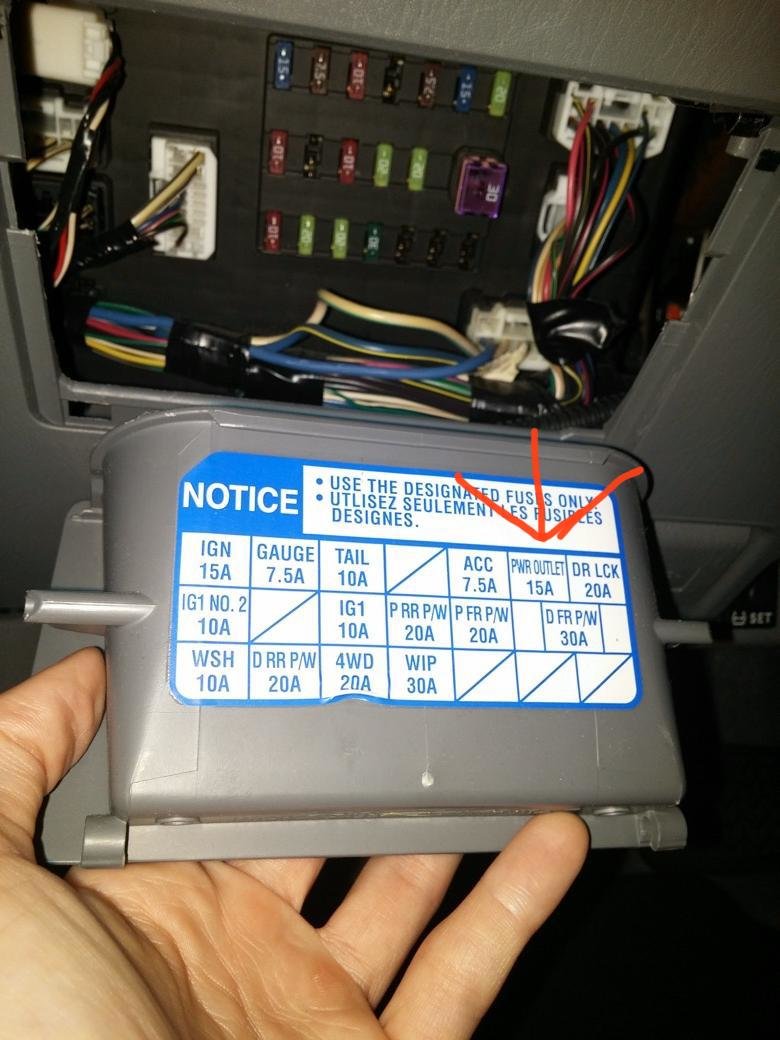

    60D207CB-193E-4BD9-8CE1-25090EE3D8A0.jpg I’m impressed that you were able to pay for it outright. Not many people can do that.
    The power outlet problem is more than likely a fuse. Someone plugged something into it that draws too much current.
