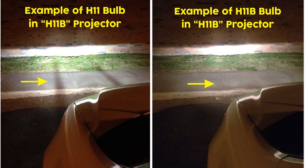

    What size OPT7 bulbs are everyone using? I got the H11B but they don't have a seal to the housing and bounce on rough roads. Their customer support said our truck needs the H11, not b.

    Their customer support is wrong. H11B in HID simply reverses the return wire so the shadow is not in the projector beam. All else is the same.
    H11B is what you should be buying.
