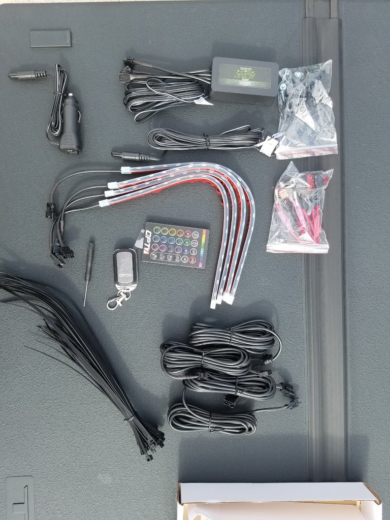

    What comes in the box:

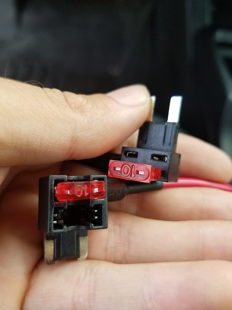

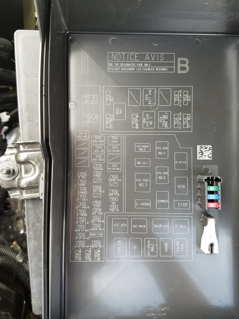

    I used the bottom left empty spot as my power source and grounded it to the nut that the control panel is on.
    Pic of the attatchment
    I used zip ties to connect them, the smaller ones. In the back i attatched it to one of the oem seat bungies. Front passanger i used the plastic part on dash, there were already holes. The driver side was a bit more tricky, i used a wire and just carefully installed a zip tie, it is hanging more than anything.

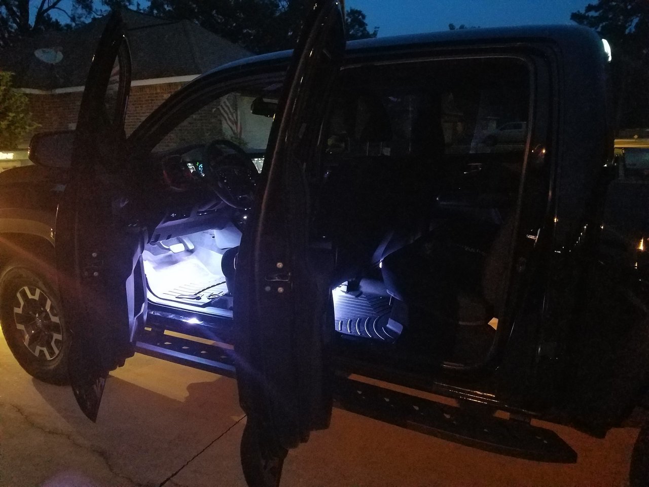

    Pic to come shortly when it gets dark

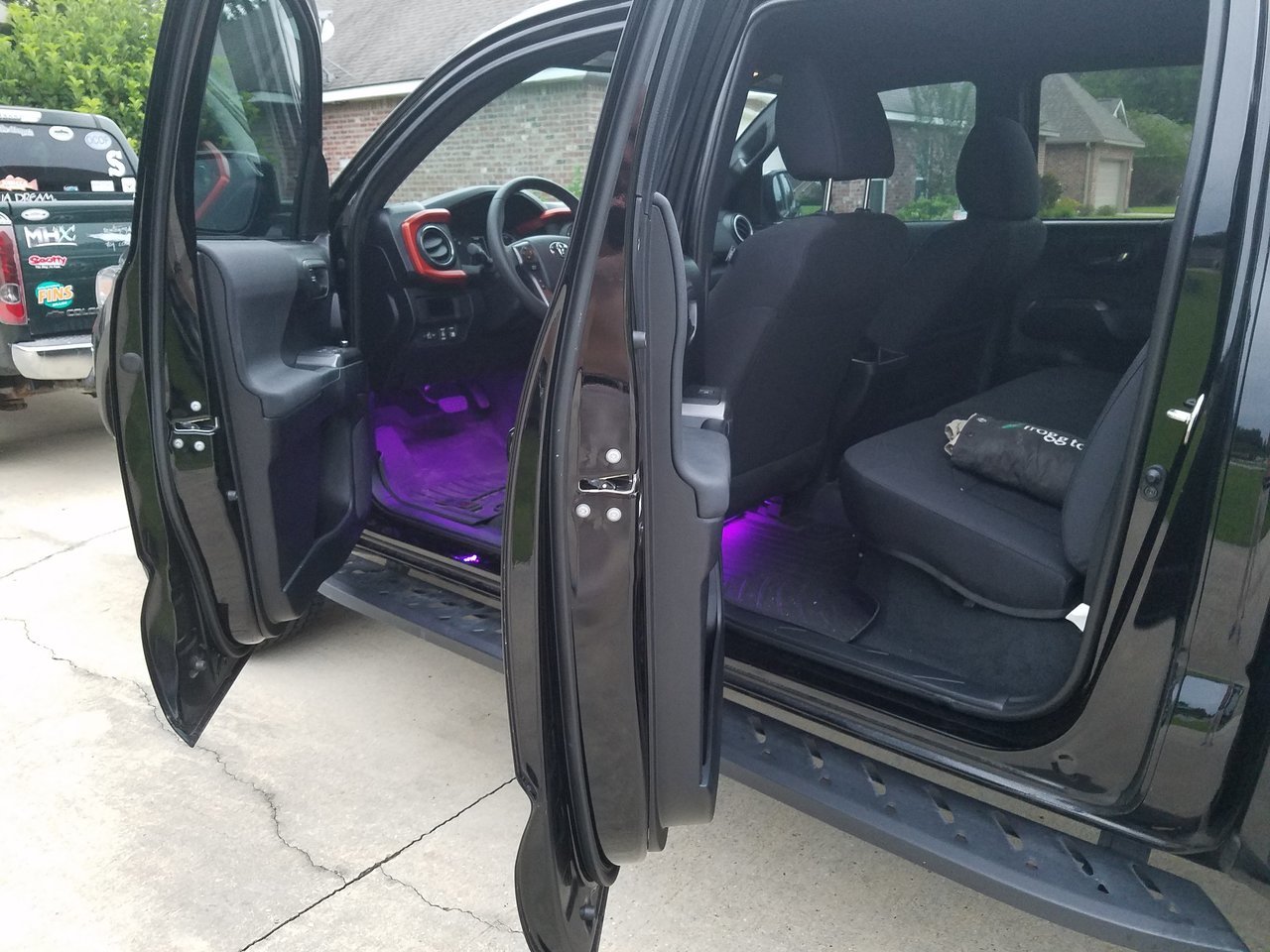

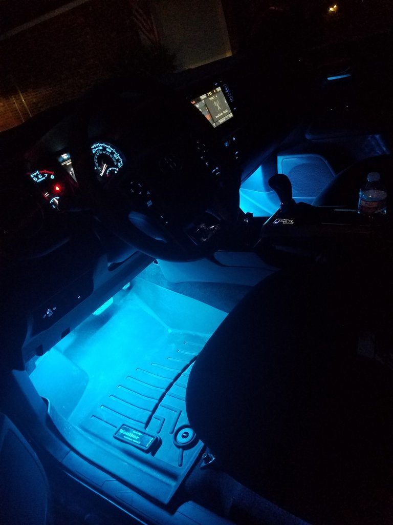

    Im very pleased so far. Even the white if your not looking for anything flashy is awesome. Tons of settings, i would need to make a video to show you all the colors and settings.
