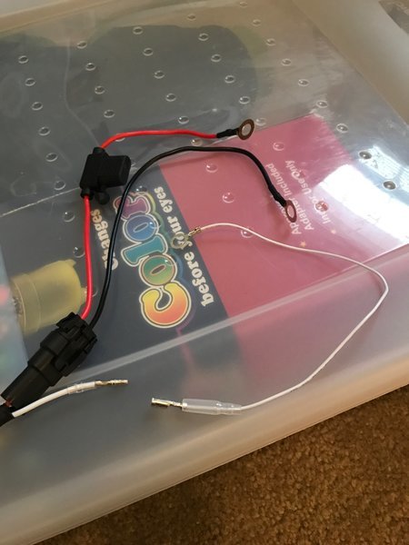

    I have an Opt 7 LED bar that I really like but recently have had some issues with it coming on by itself. It has left me with a dead battery at the airport after being gone for 4 days and has came on in the middle of the night every few nights.
    I have the wireless remote kit from Opt 7 and they have actually replaced that kit once because of this same issue but I still have the same problem. I have the wireless remote kit hard wired to the battery like they recommended but it seems I need to have it wired into a fuse that only has power when the truck is on.

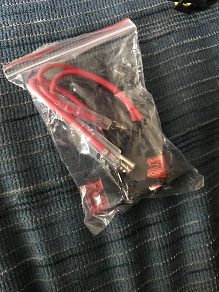

    Does anyone know what I can do? They sent some cords with fuses pictured below and I tried plugging the one that fit into some of the fuses under the hood and the light would never come on. Opt 7 only provided these instructions
    "The white wire can be used in two ways: (the parts included for this installation is the long white wire with both ends soldered off, a short wire wire the a ring connector, and the 3 sizes of fuse taps.
    First way is to connect the lights straight to the battery:
    Step 1 : Connect the long white wire with solder ends on the white wire found on the wire harness
    Step 2: Connect the short white wire with the metal ring to the long white wire
    Step 3: Connect this together with the red wire which is the wire that goes on the battery.
    (-Use this installment if you would like to have constant power going to your light bar )
    Second way is to connect to fuse taps:
    Step 1: same as step one above
    Step 2: chose a fuse tap that will fit and use that to connect to the long white wire
    Step 3: Find a place to put the fuse tap in that does not have constant power.
    (-use this if you do not want constant power going through the light bar. This installment is best used if you have frequency issues with the harness)"
    Below are some pics. I currently have the white and red on the positive of the battery and the black on the trucks ground. How would I wire this to a fuse so that it only gets power when the truck is on?

    Does the wiring harness have a relay in it somewhere down the line from the pictures that you are showing? If so, I would guess that the relay has gone bad, and you need to replace it with another one.

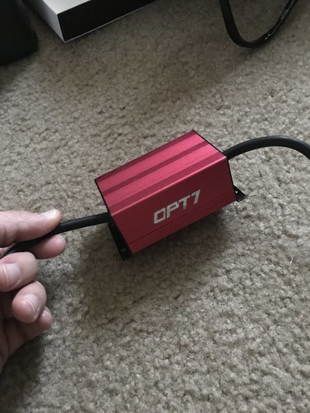

    Would this be it? They have replaced this.
  4. Jan 31, 2017 at 1:57 PM
    oorah54
    oorah54 Well-Known Member
    May 13, 2016
    #186887
    566
    Darren
    Guyton, GA
    2015 Blue Tacoma Base
    I'm not even going to lie and pretend that I know what that is LOL

    That I'm assuming is the switch box for the remote kit, a relay is a small black square item that plugs into the wiring harness, as for wanting to only turn on when the truck accessory is on kind of defeats the purpose of the wireless remote unless your truck is on and your standing away from it and need the light bar on

    Is that like a ballast?

    Thank you for making this post. I helped me wire this correctly and is working perfectly. I wired the white wire using the fuse tap to one of the headlight fuses and it is working very well.
