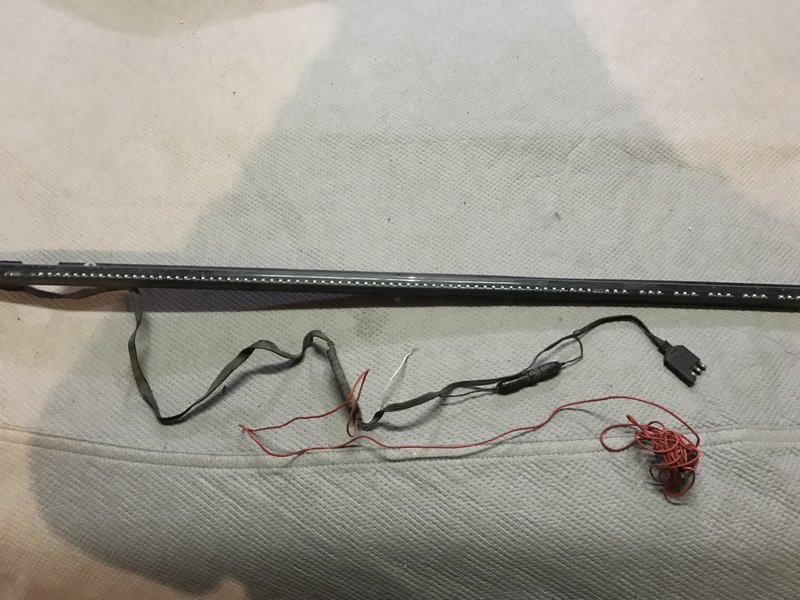

    a little nervous of cutting anything on the light bar because of waterproofing

    I just mean the plastic shroud where the 3m tape or holes are to tap into body.

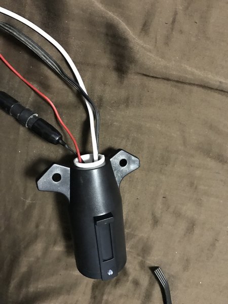

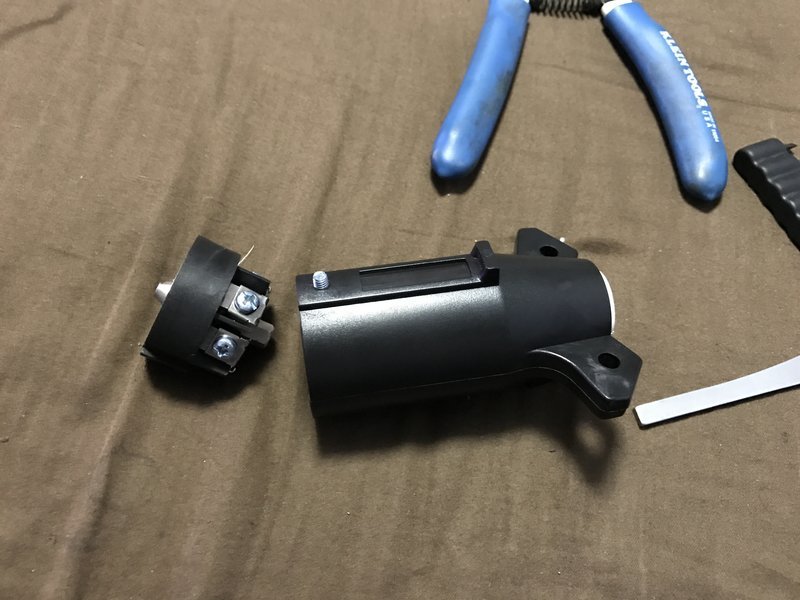

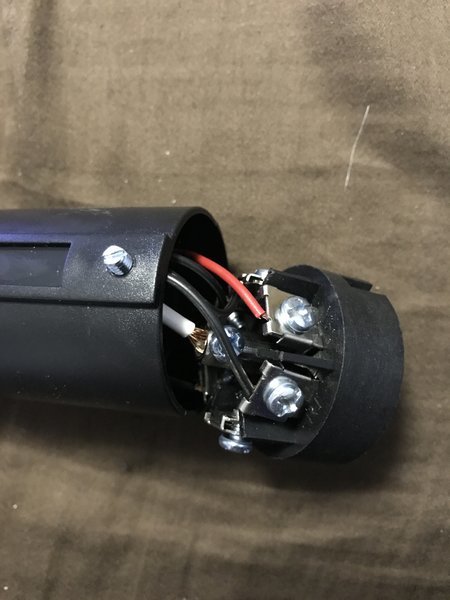

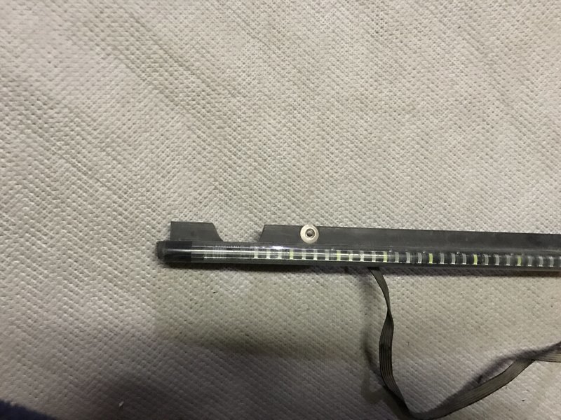

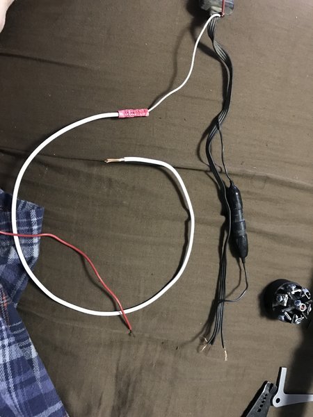

    Here are some pics, i quickly did this up on my old bar that does not work! But it will be the same for you.
    You will have a constant12v wire(red),reverse wire(white), and the 4 pin trailer harness that you will cut the end off of. Remember which wires are what if they are not color coded like mine. Your 7pin should come with a diagram and each pin will be labeled 1-7 or with letters, ax(auxil/12v) gd(ground) etc.
    In my third pic you can see where i notched the plastic for the tire carrier on my old truck.

    thanks so much for the info and pics!!!!! hopefully everything will go well.
