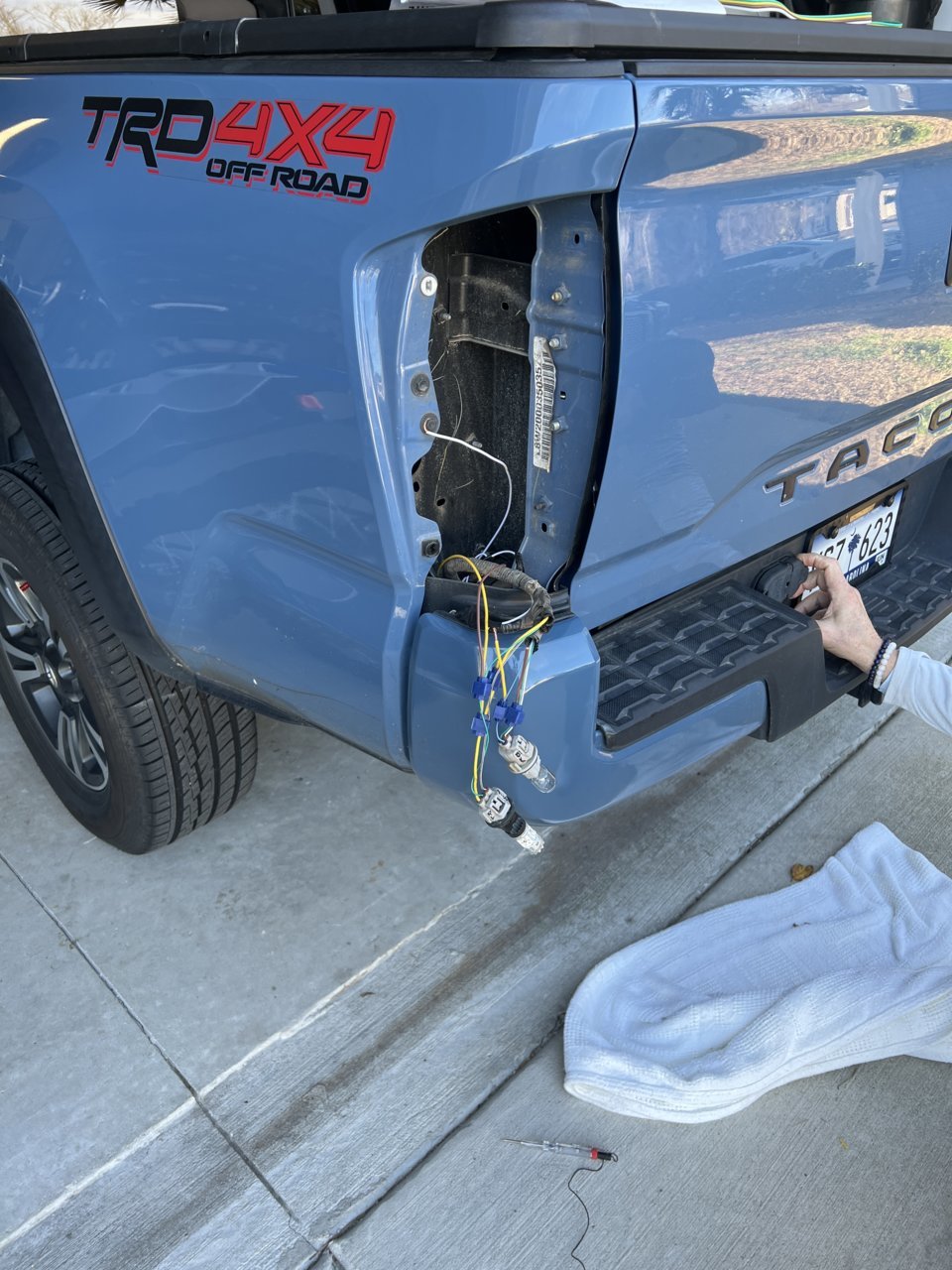

    Alright so i’ve been trying to wire this opt7 tailgate redline bar for days now. Only problem is the brake light. everything function but that. Any ideas?

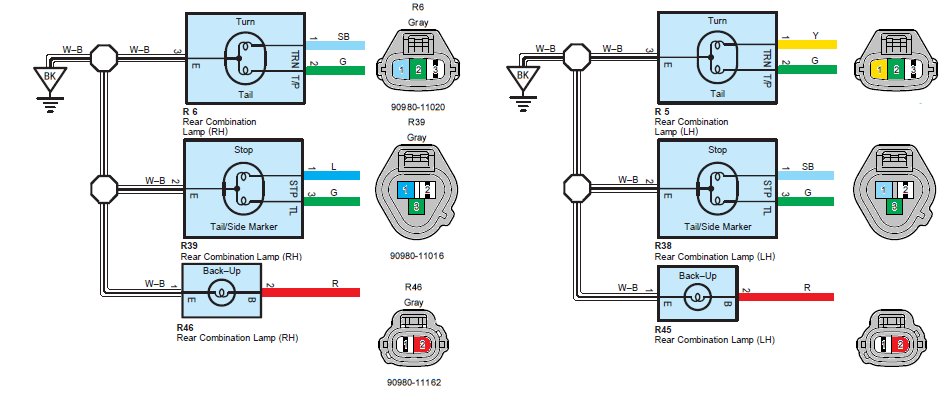

    Looks like you are wiring it into left taillight. That would explain why, only left turn and brake is working. Most get wired into trailer harness.

    just wiring the left turn signal and brake into taillight. only one or the other works… all other signals are fine. the rest are wired into the trailer harness but there’s no running lights in them

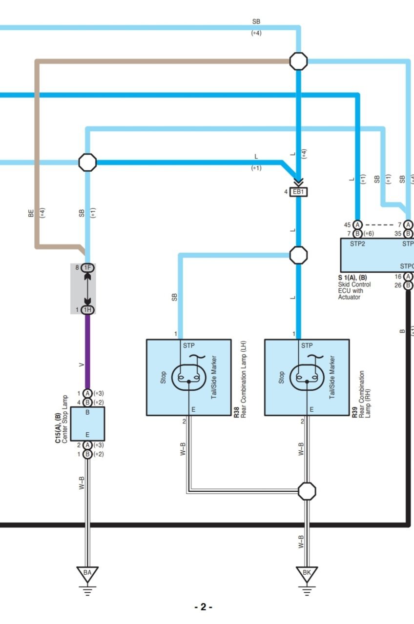

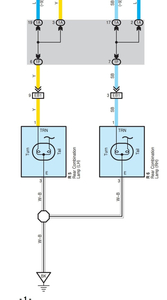

    Before you fry the taco's combination meter, don't combine vehicle wires AND towing wires to the added light bar. Towing combines Stop N Turn on one wire for left, same for right.
    Vehicle connectors:
