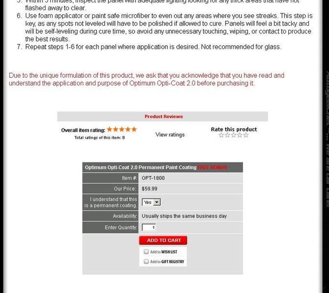

    With everything cleaned and prepped, I got out my Opti-Coat 2.0 and read through the brief instructions to apply. It comes with an applicator. . In order to maximize the OC 2.0, I placed the sponge applicator in a nitrile glove and wrapped that with a plain blue shop towel. Doing this allows you to apply with the soft sponge, but blocks the applicator from soaking up all your OC 2.0. I'd recommend it.
    OC 2.0 goes on very light and just a little applied to the wrapped applicator goes a long way. It will go on hazy with a slightly oily appearance and should (almost immediately) flash to clear. If it does not flash, buff it a little with the wrapped applicator and it should do the trick. OC 2.0 is self leveling, but applying it too heavy can leave "swirl marks" on the finish and as scary as that may sound, it's very easy to avoid. I did one panel at a time with a 5-7 min break in between to confirm everything went on well and flashed clear. Apply the OC 2.0 in a single direction with the first coat and then immediately wipe across the grain of the first coat immediately after initial application to ensure a nice level coat. It should spread well.

    Hmm...
    $16 for the no-rinse wash.
    $12 plus shipping from Europe for the P1
    $15 for the CPE
    And finally...
    $103 plus shipping?
    Only references from Autogeeks?
    I'd trust the Autopia/CMA references more... been around much longer than AG.
    Would be interesting to see what the Autopia crowd thinks of this, but I have a feeling it's going to be :yawn:
