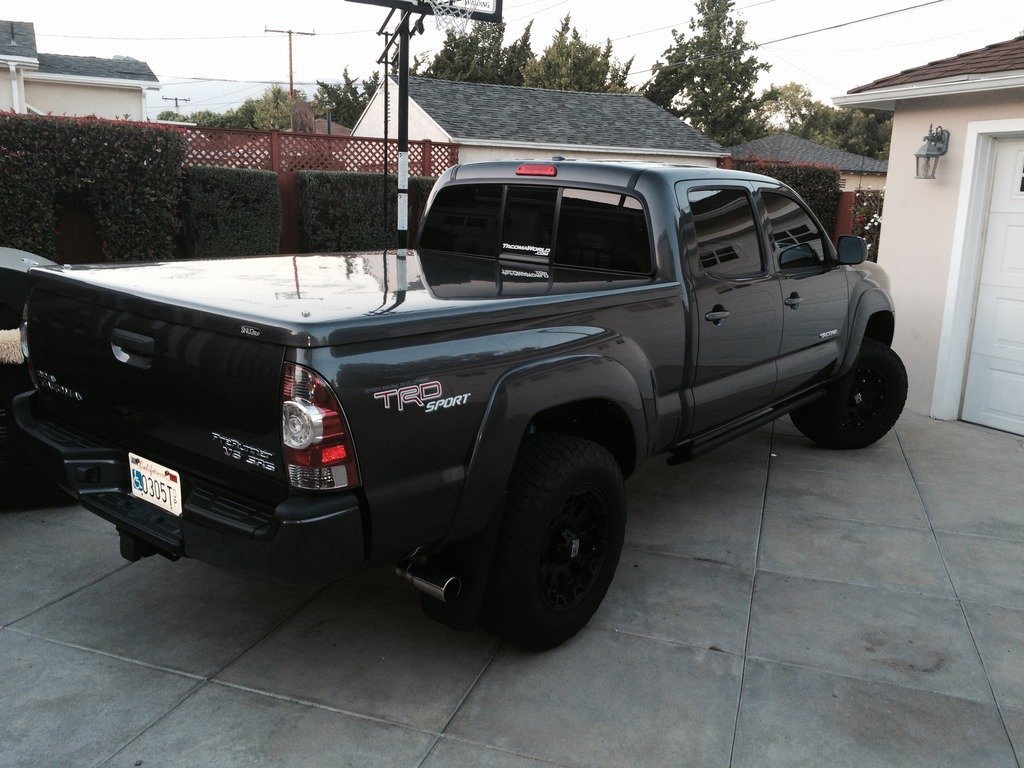

    Great stuff. I have it on my truck. My truck is 5 years old and it looks better than when it was new.
    Truck looks clean even when it's dirty

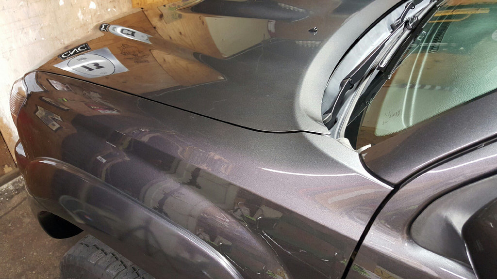

    When you say paint has to be near perfect do you mean like no scratches or spider-webbing at all? I did a full paint correction myself on my rig back in march and then I was stupid and took it down a narrow trail, it got some light brush scratches on it, but I know that the original paint correction I did probably removed enough clear coat to where you wouldn't want to use any abrasives on it again. Or would you say that it would be safe to use a less aggressive polish like Meguiars 205 again? My truck was practically brand new at the time of the original correction I did, just to get it 99% perfect, it's a '15. So would you say it'd be safe to do another light, and not so aggressive correction to remove minor defects? Thanks!

    color correction if done right...you would be able to do several times before you got down the base paint. If you have a 2015 and you did a one time color correction and then you feel that you can't do it again...you did too much abrasive. The point of color correction is to remove all defects that you can remove. You wash the truck, clay bar, wash again, then you remove all grease and residue left from cleaning and claying. Now you do color correction for any light scratches and swirl marks that you can remove. The point is that once OC or any other paint sealant is that any defect not removed is going to stay and show when you apply the paint sealant.
    If it's only a section of the truck that has deep scratch and you can't go any further...adding OC will add a mini layer of protection... If you do it yourself... then wouldn't be bad...worse comes to worse is that section of the damage is resprayed. The worse part of paint repair is color matching. I had a black car and a pro shop with big reputation didn't color match to my standards...I was never happy with it...but black is hard to color match.

    Do you have the opti coat pro or the do-it-yourself opticoat 2.0 ???
    That looks really good. How's it holding up?

    I believe it's the pro. Unfortunately the truck stays outside, I use a cover once in a while but it's a pain to put on and remove, specially when it gets wet after night. Since we don't have water to spare here in Cali, I'm also using meguiar's D115 rinse free express wash and wax. After I'm dome the truck looks great again, And if it gets a dirty you can still see the reflection.
    I would higly recommend this product. Just make sure it gets installed by a professional and that the paint it's flawless before the application.
