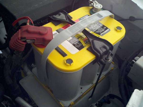

    I like my yellow top. If I remeber right it wasn't much more $ than the red.
