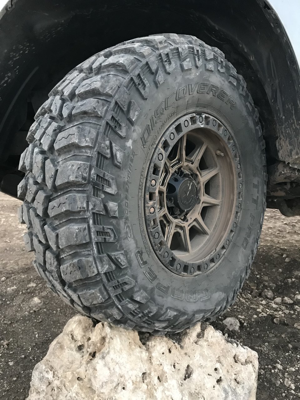

    I am stepping up to 285x75x17 on 17x8.5 w/4" bs. Will be running a MT type tire. Cooper, Goodyear, Nitto. Haven't made up my mind.

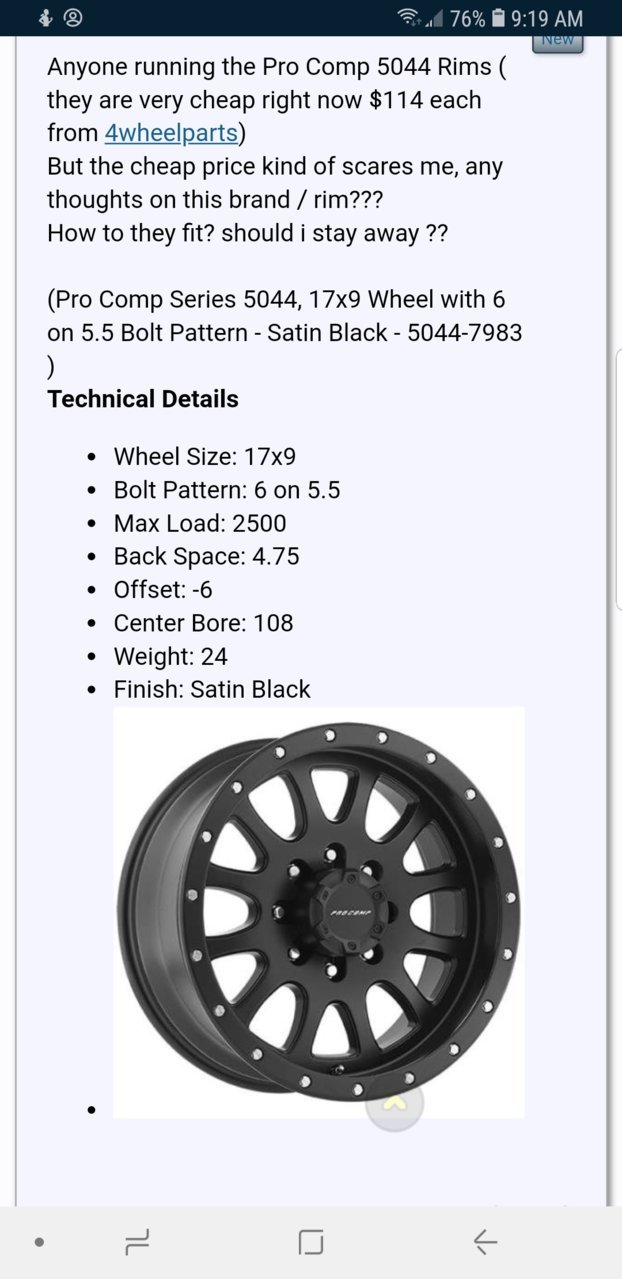

    Good price, but cheap wheel.
