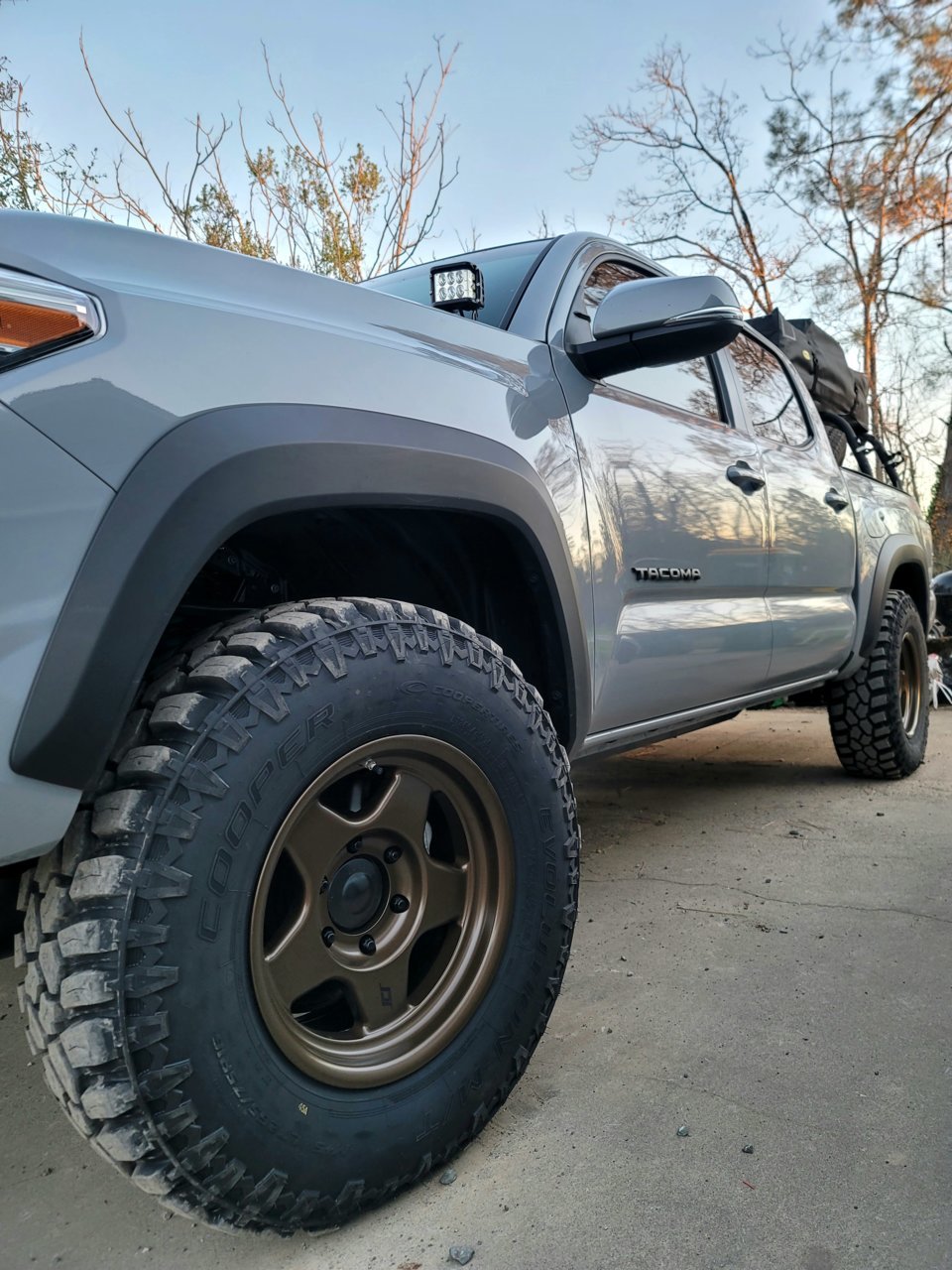

  2. Apr 7, 2021 at 9:02 PM
    #22
    TRD_SKeTcH
    TRD_SKeTcH Well-Known Member
    Mar 10, 2021
    #358800
    53
    2021 Tacoma TRD Sport
    Awesome! Thank you for the reply. Oddly the tire guy said I'd likely rub the liner where the cmc is amd hit my fender. He was worried. Kinda bummed. Should've just took a chance!

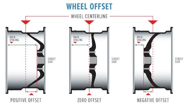

    Isn't an 16x8 0 offset 4.5 backspacing? I think you'd need -12 to hit 4" bs

    Yes. Apparently my numbers are slightly off because the width measurement of a given wheel is taken from between the beads, not outside-to-outside, good catch

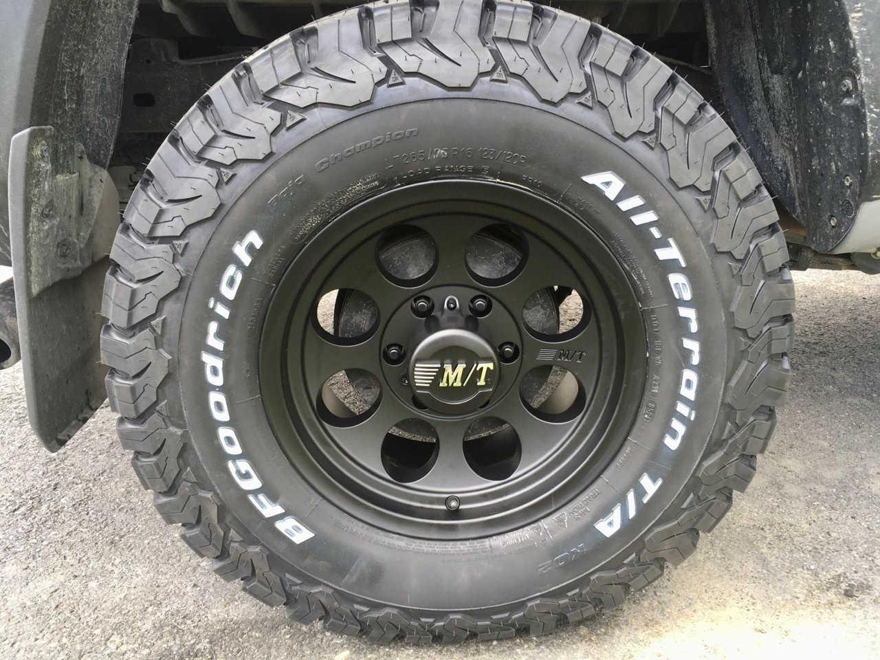

    I run the micky thompson TRD knock offs 4,5 side biter 2's

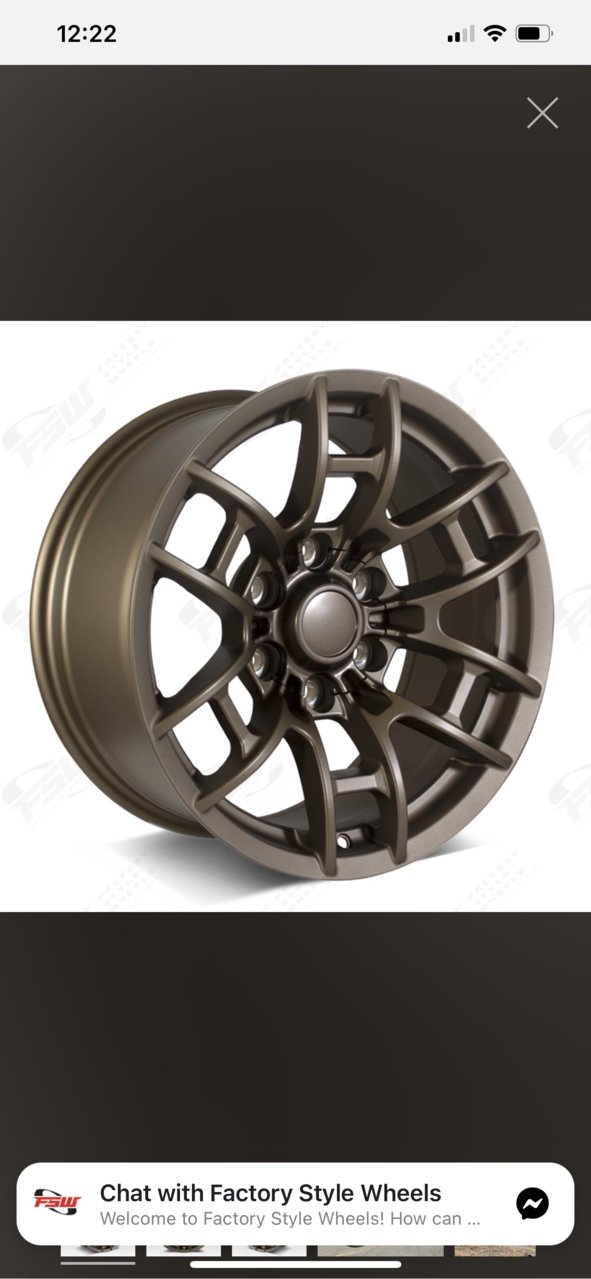

    I like the FSW Pro Style 2020. I just received mine, and should have then mounted tomorrow. 16x8 with 0 offset. They look good, are light weight and reasonably priced.FA49174A-19A2-48E4-8551-ACA57045BEE0.jpg
