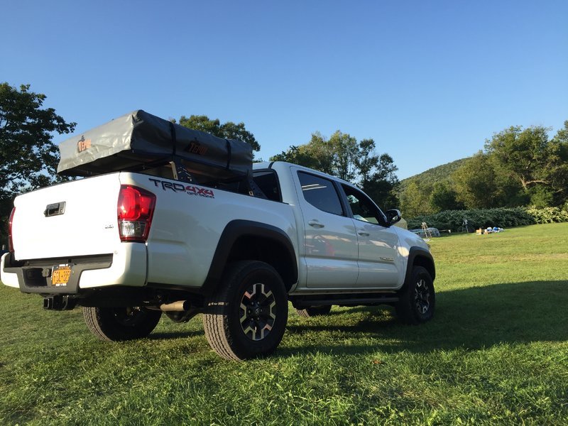

    Hey guys new member to Tacoma world. Recently got a 2016 trd OR short bed and I'm already planning a cross country trip with it. I've seen a few threads regarding lifts and from what I can see most of them are for off-roading or asthetic purposes. Im trying to go for more of an additional weight carrying route in the rear. I already have a Tepui Ayer RTT that's approx 100 lbs with CBI 3rd gen overland bars and I plan on adding an additional 250-300 pounds of weight in the bed once everything's all set and done. Any help on what you guys think would be the best route to help hold that extra weight. I was thinking about adding an extra leaf spring, any help would be much appreciated!

    if you are still stock, your rear end is 1 inch higher than the front. A 400 quad pounds leveled my truck out with gear in the back seat.
    You should be fine

    Interesting, I guess it's just my eyes then because I felt like I noticed some sagging in the back with just the tent on it. I'm taking it cross country for about a month so I also don't wanna wear out the stock pack
