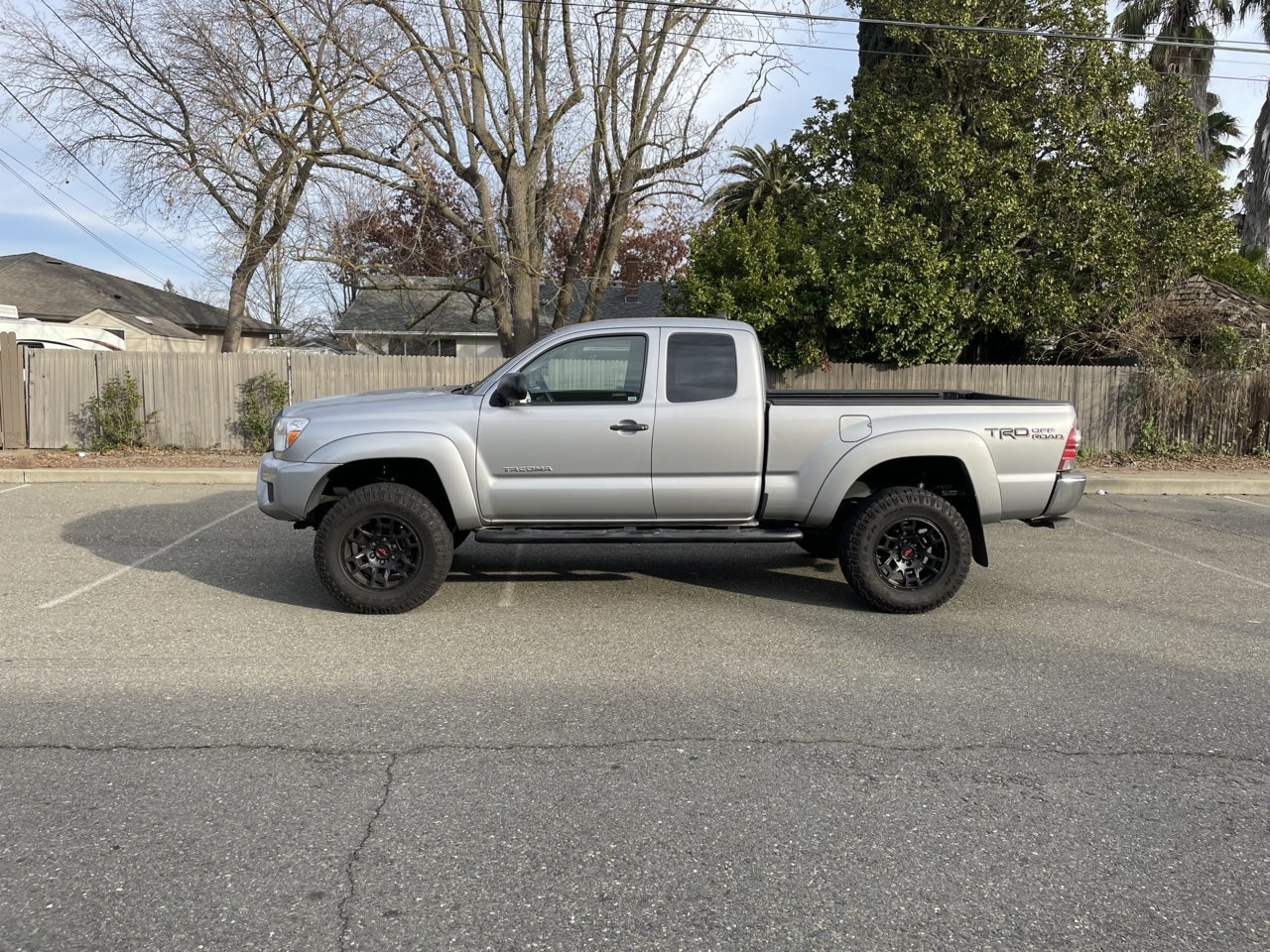

    Okay, so I just installed a new suspension last weekend.
    SPC UCAs, Bilstein 6112s (gen 2 4th clip), 5160s, and an Icon AAL. I did the ECSG bushing a couple weeks ago.
    It’s all aligned and dialed in now. However, I’m not happy with the rear lift. The rear is a little too low. I’m looking for an additional 1” or so to level it out.
    I did not install the overload spring per Icon’s instructions.
    It seems these are my options:
    Add a block (I want to avoid this)
    Add the overload (seems similar to the block suggestion and after speaking with icon will actually increase stress on the leafs).
    Buy a whole new leaf pack.
    Looks like the best options are deaver, all pro, Dakar OME, and ICON rxt.
    I have no load in the bed. Mainly use the truck around town, but take it camping, on trails, and in the snow.
    I definitely don’t need something high end, but I also don’t want crap that’s going to be a waste of money.
    Have I covered everything? Is there something I’m missing? Would a block be an acceptable solution or is that just a bad idea? Are the OME and All Pro options solid?
    Any help would be greatly appreciated.

    I’d do a whole new leaf pack. I’m not sure how good the stock ones are but mine rides a little stiff in the rear. Same truck. By the way, what size tires are those?
    Stagger Lee[OP] likes this.
  9. Jan 6, 2022 at 6:03 PM
    Stagger Lee
    Stagger Lee [OP] Well-Known Member
    Jul 7, 2015
    #158941
    108
    NorCal
    2015 Tacoma TRD OR 4x4 6spd
    I think that’s probably going to be what I do.
    I’m looking at the OME and All Pros. Seem to be a solid middle of the road option. Been reading through posts trying to gather info.
    These tires are 265/70/17s. Wrangler Duratracs. Gonna step it up to the 295/70s next.

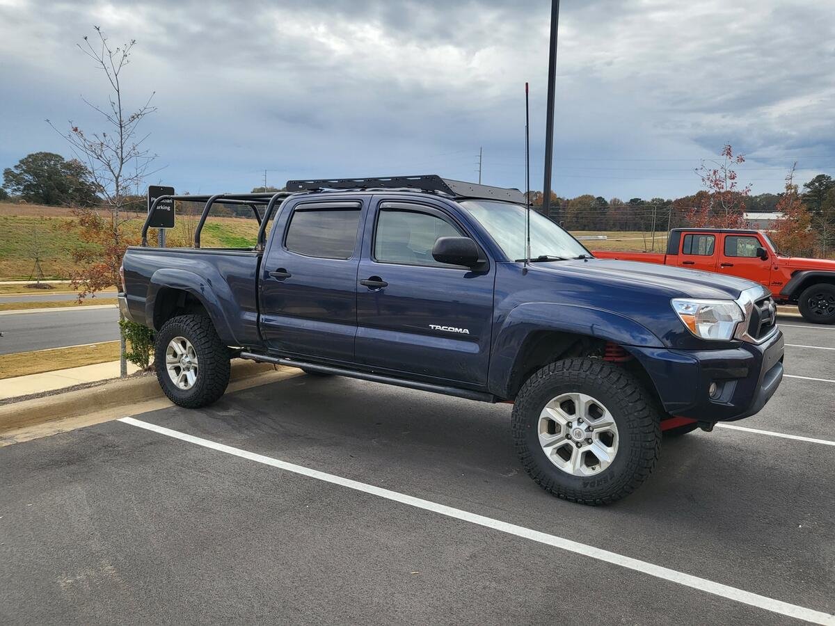

    I was coming in here to pimp @Crikeymike and Dobinsons :D That's Kenda 33x10.50's
    I even put Dobinsons leafs on my camp trailer :rofl:

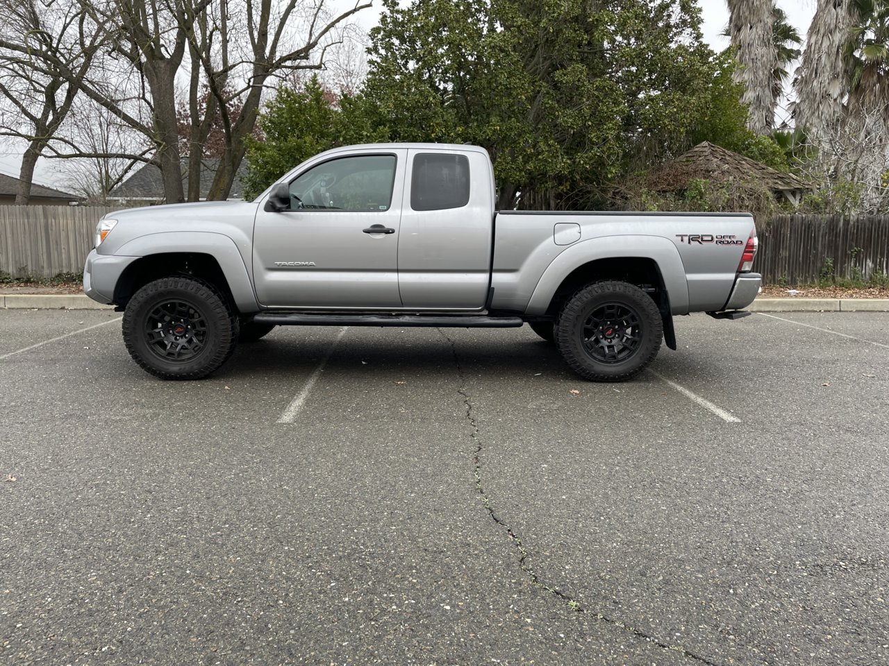

    Here you go:
    Before and after.
    Stage one. Just put them in this afternoon, so they’ll probably settle some. Also put in wheeler’s front and rear bump stops.
