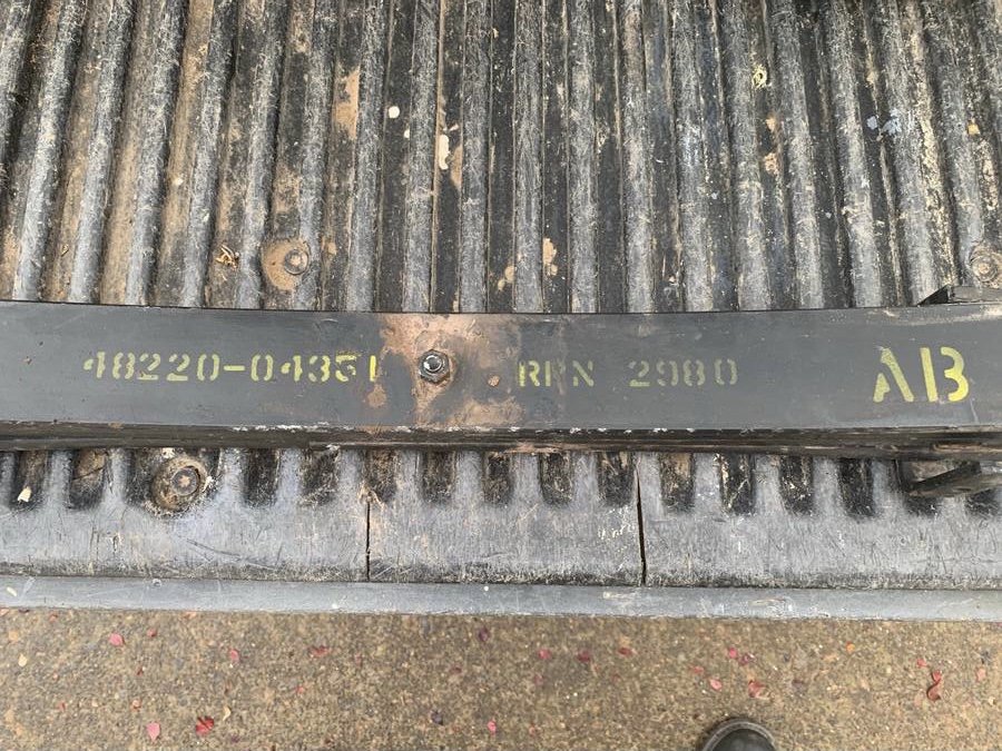

    Will these work on my truck? Take offs from 2020 OR WTH 2500 miles on them?0060D5A5-3593-4AD0-8A6F-55C0102B7BFF.jpg

    2,500,000 miles? Lol that’s a lot.
    yes, as long as you also have a 6 lug Tacoma.
