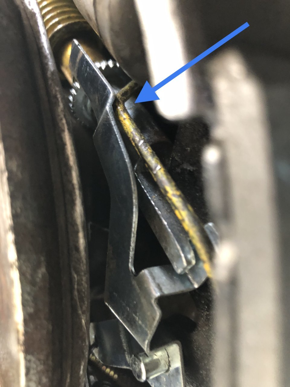

    I had my a$$ kicked by my drum brakes today.
    Mistake #1, using an after market hardware kit. (Thanks a lot PowerStopo_O)
    The upper shoe spring isn’t bent correctly and is “short” before the adjusting star wheel.
    This pushes the spring right up against the star wheel locking lever. And makes the lever not want to catch the notches on the star by much at all.
    And for the life of me, I can’t get the parking brake to hold tight.
    Brakes stop pretty good. Parking brake is “no good”
    I can’t get it to hold itself in gear. If I adjust the shoes out any farther, the drum won’t spin. Period.
    WTF……I never had this issue before.
    And I had the shoes off when doing axle seal. All went back together fine.
    But….that was 100K miles ago too?
    Honestly, I can say I ever “checked” the parking brake.
    So who know, maybe it was weak before I started?
    I don’t really want to pull the center console and take up the adjustment there. But maybe I will have too?

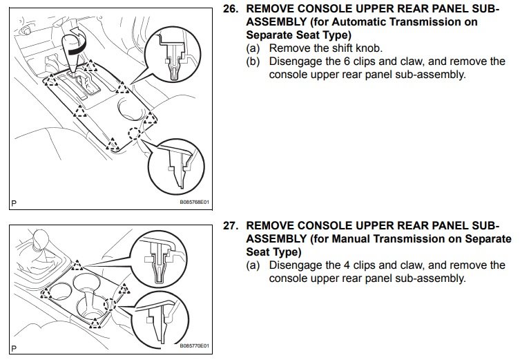

    On mine I can just pull the cupholder out and see the cables but I'm not sure if automatics are like that or not.

    That tab goes under the yellow spring and holds the star gear in place.
    You typically don't need to adjust the parking cables.
    The star gear should ratchet.

    My cup holder is part of the shift console. I “think” the upper section might pop off.
    I’m going to adjust the brakes once more “tighter”. Then move to the inside.

    I knew I should have taken more pictures.
    I’m not sure what tab you are talking about. I’ll have to look up some pictures.

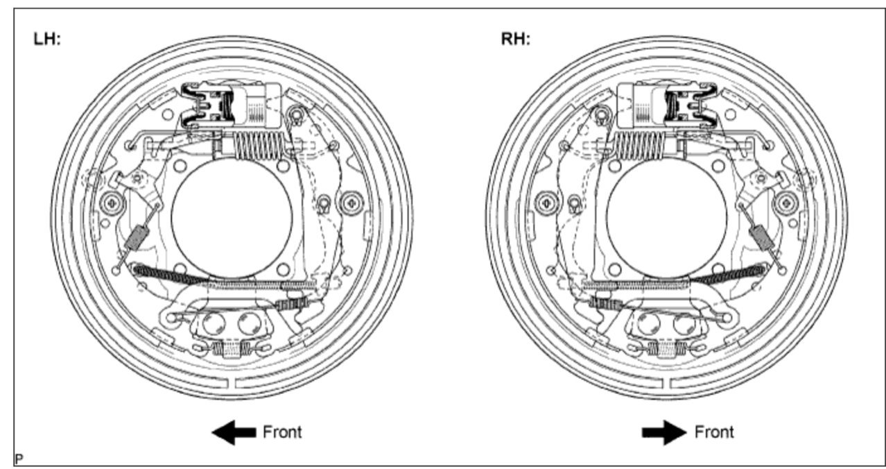

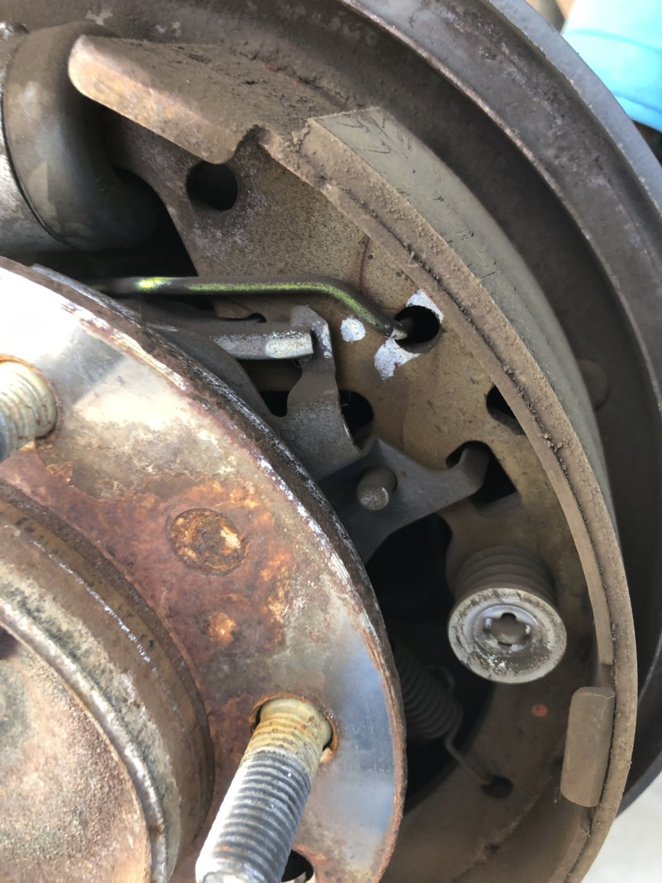

    My dad knew what he was doing.
    Either he didn’t know, or that spring is “not right”.
    I got to take just a very few picture before he tore them apart.
    I’m going to take them back apart and use the OEM springs.
    Compare this picture to the one above.

    For future reference should anyone else manage to do something stupid like I have.

    If the shoes are properly adjusted and the Parking brake is still soft you have to get at the adjustment under the console. On my auto I just take the shift knob off and pull up on the whole thing. Honestly even taking the whole arm rest and compartment off isn't that hard, it's just a few screws. That will give you even more room
