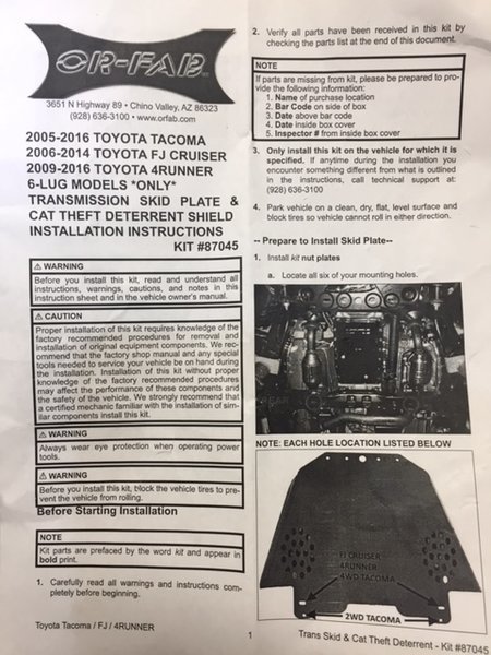

    Now the instructions suck, and there is some cutting if you have a prerunner.
    My first attempt installing this back in early September ended with lots of swearing and frustration as the nut plates won't fit in the rear cross member due to a bolt that is inside the rear cross member that blocks one side. Also, when I first attempted to install, everything was about a half cm off from the front to the back due to those nut plates not being close to the edge of the cross member holes. I didn't have anyone helping me and this thing weighs about 45 lbs as well.
    I spent about 3 hours to no avail, im sure the 90 degree humid weather didn't help either.
    So my second attempt this morning ( much cooler weather at 60 degrees):
    I used a Dremel to cut one side of the rear nut plates down about half an inch ( not the 1.25inch the instructions say to do). I cut both( one for the right side and one for the left side) and the key here is put it in perpendicular inside the rear cross member (not parallel to the rear cross member like the instruction picture shows).

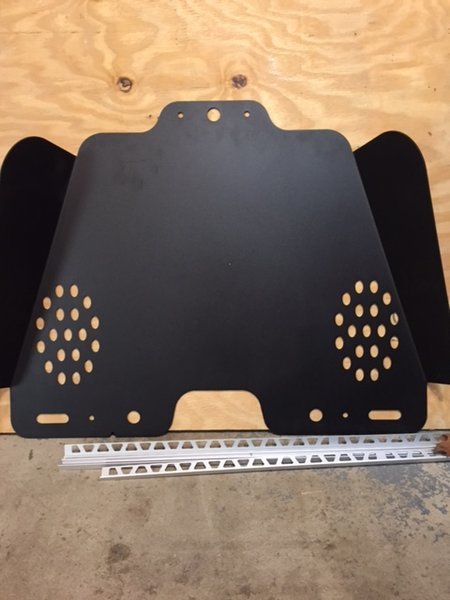

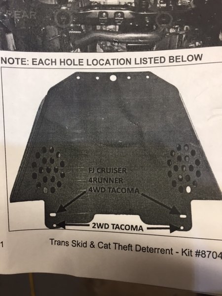

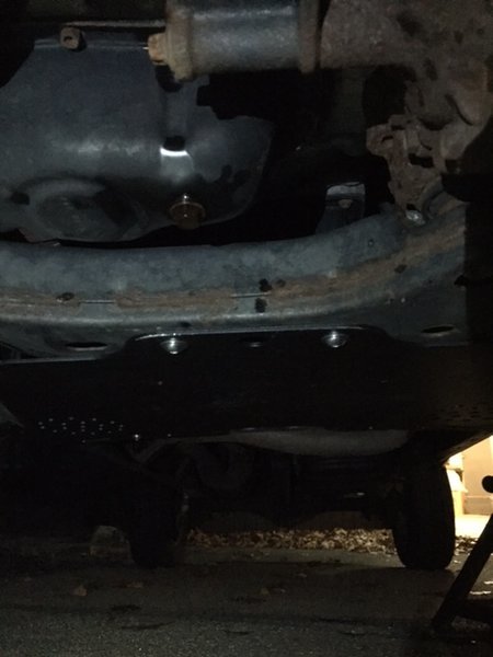

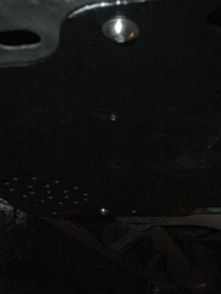

    Okay, my skid arrived yesterday and I installed it today. It took no more than a 1/2 hr to do. First I'm wondering why the op had issues and what skid he got. My attached pics show a difference between what skid is pictured in the instructions and what I actually got. I'm also curious about the questions regarding the compatibility with this skid and the factory skid and a need for shimming, which the instructions mention. My '10 trd sport has a factory skid (lol piece of tin) from the front bumper to in front of the oil pan. The OR Fab skid mounts on the next cross member back, right behind the oil pan, and goes to the next cross member. Do OR models have and additional skid covering the oil pan that my sport doesn't have? Or, this skid also fits FJs and T4Rs, do those have different skid configurations that require this shimming? Also, the instructions say you will use 6 bolts, and show a skid with 6 holes, mine has 4.
    On to what you're all here for - my install and tips for an easy one person install. You will need a 7/32s allen key for the bolts. To start, my truck only has 5100s set at .85"and stock size tires, so I needed to jack it up several inches and put it on jack stands to install. If you're lifted and on bigger tires, you probably won't need to do this. Next, I slid a milk crate under and got the skid on top of that, then put a 2x4 piece between the crate and skid and that got it close enough to the frame that I only had to push it up a half inch and could move it around to align. If you're lifted you might need two or three 2x4s. I had none of the ops' problems inserting the nut plates or with alignment of the holes. Put the plates in and push the skid up, then use the allen wrench or a small screwdriver to center the nut with the bolt hole. I ran a bolt through each nut plate to chase the threads and insure the bolt went in easily and here's why. The plates lay loose in the cross members and you thread the bolts up into them and you have to be gentle, or you knock the plate away. Put the bolt on the allen key and turn it as they meet and the bolt catches the nut no problem. Give it just a turn or two and you'll have plenty of wiggle room to do each remaining bolt then snug them all down once they're all in. Done. Sorry I'm so long winded, I like details, and I hope this makes it easier for someone else. Chads Pride will like this:D.
