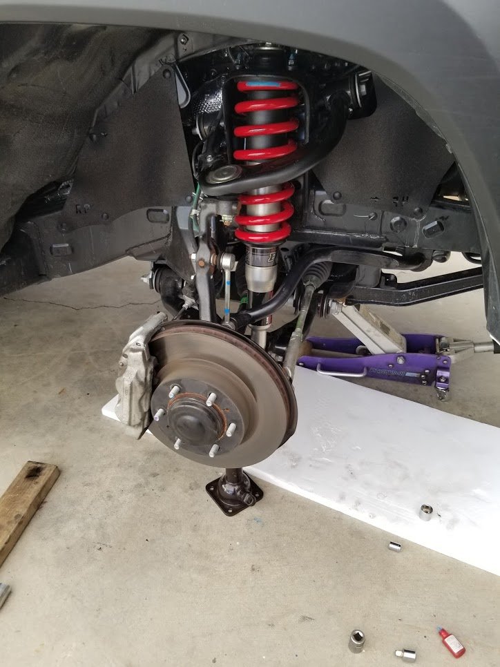

    Rear shocks look pretty easy, but for the front coilovers it looks like you might need to loosen the lower control arm bolts, remove the swap bar nut, and remove the lower ball joints bolts?? anyone please let me know if there is a way to remove without loosening the lower ball joints and lower control arm. is it necessary?

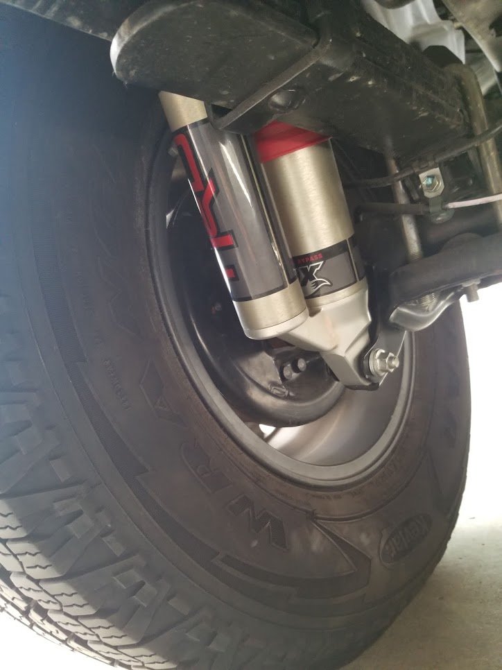

    I Just finished the install, i didn't loosen the lower control arm but just used a 2x4 between the lower arm and upper frame bump stop. it didn't need a lot to make it clear the coil over, but i did have to remove the upper sway arm bolts. Rears took about 20 mins, i left the tires on so i had to hurry/compress lower shock and run under the truck to insert the lower bolt. coilovers took about 45 mins each to be careful and get all the correct torque specs. oh and i was lucky enough to have a bag full of bolts that did include the rear ebrake passenger side spacer. probably easier on a lift or whatever.
