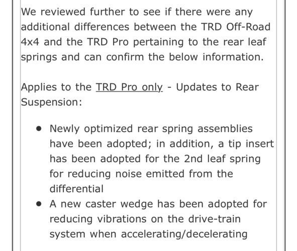

  11. Sep 4, 2020 at 6:43 AM
    #311
    St0rm-Tr00per
    St0rm-Tr00per Well-Known Member
    Sep 7, 2018
    #265560
    1,266
    SoCal
    2018 TRD OR 4X4 DCLB - Super White
    “Semi-Pro”/“PrOff-Road”
    according to this e-mail response from Toyota (from another post), even though seemingly minor, there is ...

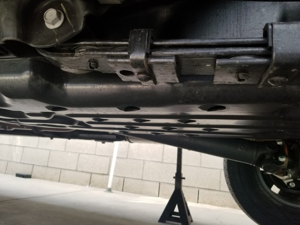

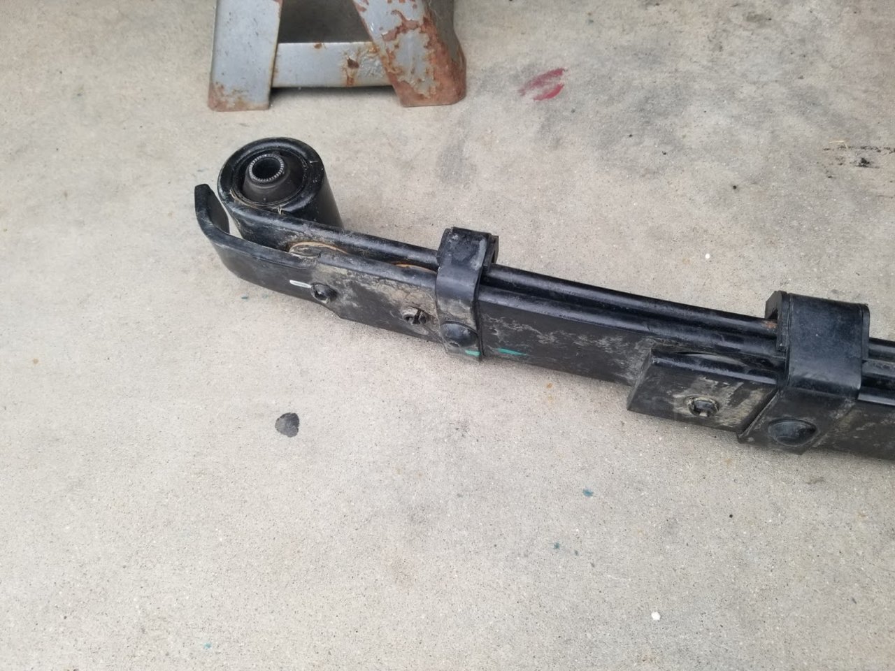

  18. Sep 4, 2020 at 8:53 AM
    #318
    jruiz555
    jruiz555 Well-Known Member
    Jan 12, 2019
    #279080
    1,184
    just looking at the PRO leafs vs TRD OR, the only visual difference i see is that my OR leafs have a 2" metal plate near the front of the leaf. The PRO doesn't have this, and the thickness of the leafs look to be be the same. I am thinking that the metal plate is used to limit the travel of the leafs? anyone..

  19. Sep 4, 2020 at 9:41 AM
    #319
    jruiz555
    Jan 12, 2019
    #279080
    1,184
    Wasnt worth the time after seeing the parts, off to alignment

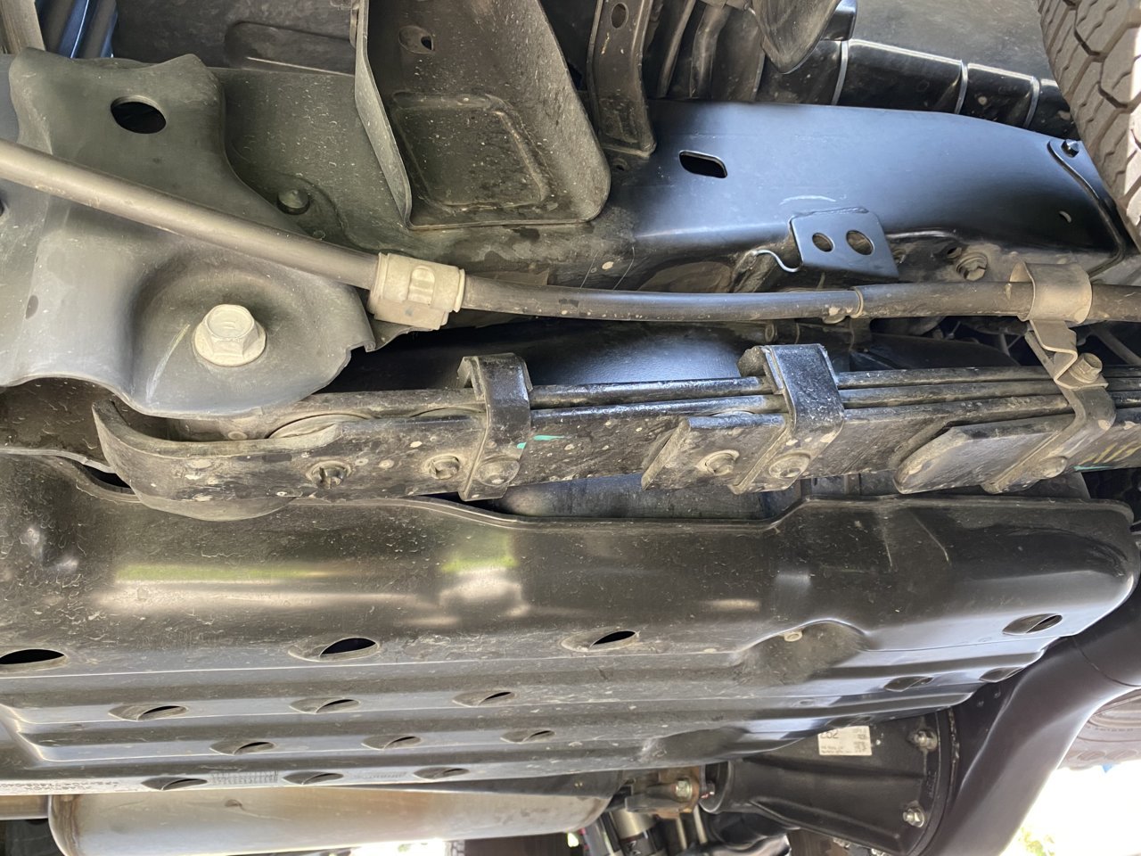

  20. Sep 4, 2020 at 9:54 AM
    #320
    St0rm-Tr00per
    Sep 7, 2018
    #265560
    1,266
    SoCal
    Hmmm ... my LB OR looks different than yours
