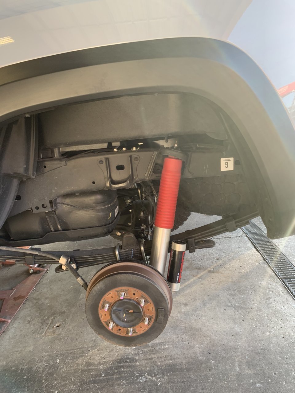

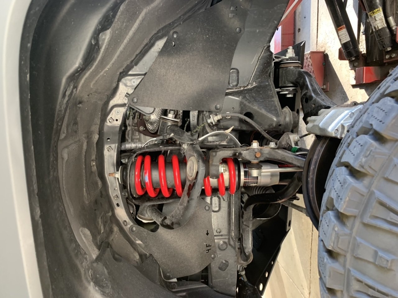

    Installed the new suspension system yesterday, it went very well, took me less than 3 hours total working in my driveway alone. Took it for a ride on some rough stuff to check out and everything looked and felt solid. Did a wheel alignment this morning and castor and toe in was out just a bit. It lifted the front just a bit from the OR suspension. Now sitting 36.5” front, and 37” rear. Couldn’t be happier, best $550 I have spent in a while.

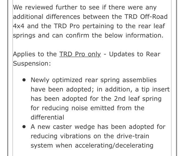

    Is there a significant difference between the OR and PRO leaf springs?

    No, they are the same.

    They are actually a little different according to Toyota …

    So, performance wise there the same. You guys think it’s worthwhile changing them?
