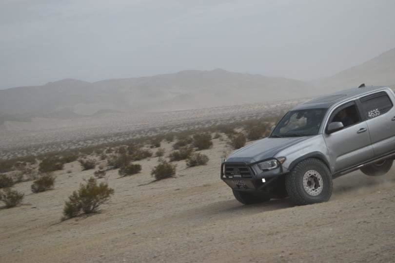

    Excuse the crummy photo, but ran the whole Koh desert course, along with probably 60-70 miles on top of that at King of the Hammers with Pro fronts. Lots of jumps, constant pogo-ing the front end since its still stock travel, and boiled them over for long periods of time. Melted both the lower bushings and the upper isolater in the top hat.
    Besides the bushings, they still ride perfect afterwards lol. I think with a little bit of tuning, they can be a pretty great shock setup for a "stock" shock. Running 650lb springs on them, so nice and firm on road.
