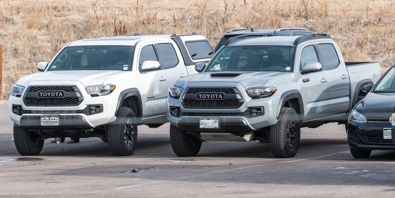

    For those curious - here is a stock pro next to a TRD off-Road with 3rd Gen Bilstein 6112/5160 combo set at 4/5 setting.

    The pro sits one inch higher factory than the OR and has a 1 inch wider stance due to the offset change from +25 on the OR to +10/11 on the pro. Pushing each wheel out a 1/2 inch. Fox is decent, you're more paying for the name. Just hope you never have an issue. They're terrible to deal with, whether auto or mtb. I was gonna get the pro, but would've junked the fox right from the rip.

    Yep, my Pro is 1" higher at the wheel well and top of cab than my 17 OR.
