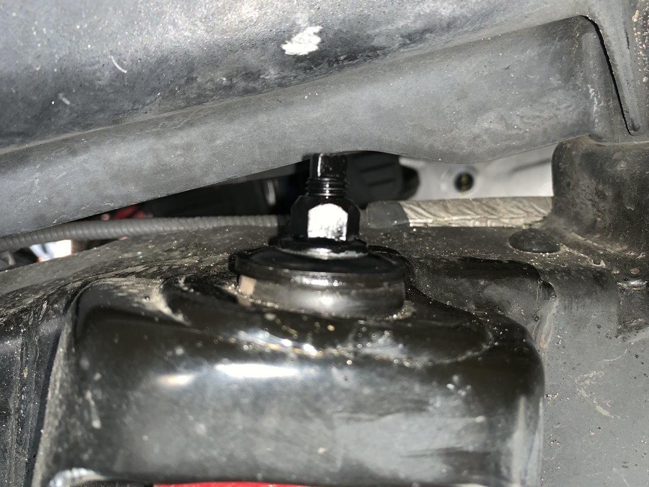

    So I have done this conversion, but had an issue with the hardware. The rear shock bumpers caused an INSANE squeak (they had 30k miles on them, so I'm not mad). Anybody know what part numbers I need for the shock tower hardware? (Rubber, washers, nuts, etc.)

    All you need is the rubber bushings. Why don't you use the ones from your previous shocks? Nothing wrong with the washers. Another thing is to make sure you tighten those suckers down pretty good. If that rubber bushing can move it will make a noise. Don't be afraid to crank down on those nuts. If you don't have your old bushings, take one of the PRO bushings to Auto Zone or any parts store. I'm sure they could hook you up.

    Yeah, I think I'm going to do just that. I still have my OR shocks but the bumpers look different?
    Maybe my mind is playing tricks on me, I emailed Gunny to see if they are different part numbers.

    Installed mine, no squeaks. I torqued them down to 23ft/lb, then painted over the nuts to make them look good and prevent rusting :)
