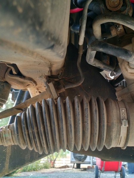

    Toyota doesn't weld that section up completely so it the perfect area for a crack to start. At least it is an easy fix.

    What are you going to do to fix it, plate both sides? I can't really picture that piece of the frame on a 1st Gen so I don't really know what you're dealin with.

    It's a 5 lug specific section. Going to grind the section. Drill the crack end. Weld the crack. Grind the weld flat and weld 1/8 plate over that section. Both sides. High tension area because of my bump stop.
