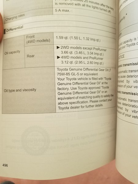

    I prolly put more lol, I fill it up until I see oil coming out...

    You can run it both, but me I run 140w rear. Y? Coz rear is being use most of the time, more sheering going on, now 140w stated that it prevents more Sheering coz its thicker consistency wise.
