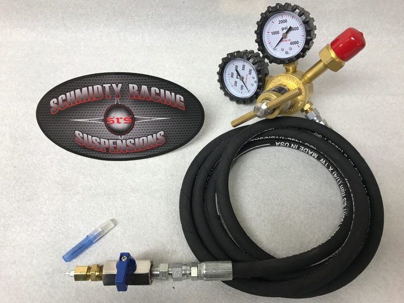

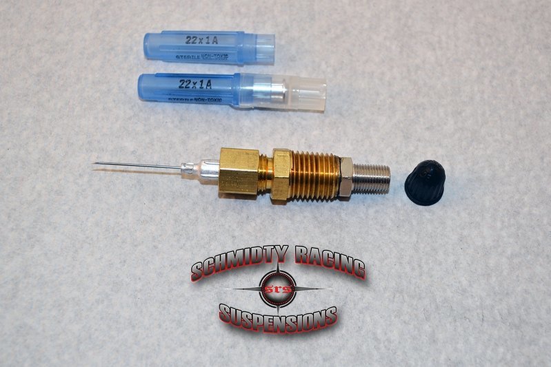

    N-FT-NE-SHR-3.jpg s-l1000.jpg cost about $20ish for the needle schrader valve setup. The whole setup with gauges and hose and needle are about $140ish. You will still need a tank of nitrogen.
    ODNAREM, TXpro4X4, madsand and 2 others like this.
