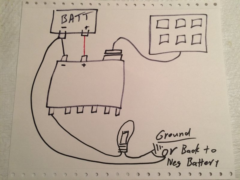

    switchpanel02_wiring.jpg If you can read this diagram it should kinda help explain what's going on.
    Edit: Ha! Not really. Sorry.

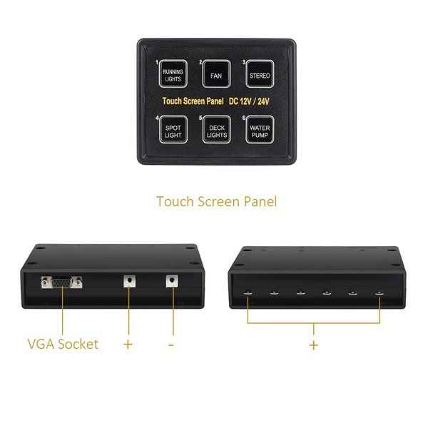

    I understand how to power it. I don't get how the switches will work. I'll play with it tomorrow.
    Look at the first picture. Those are the male terminals and there is 6 positive wires with female connections ready for it.
    Not really. I'll take a pic of the "instructions" when I'm home

    Positive and negative goes to battery. Vga plugs into the switch panel. Positive from light goes to positive connectors on box. Negative on light goes straight to negative on battery or ground. Push button on switch panel to turn on/off.

    Wait what? There's usually 3 wires to the switch. Positive, negative, one other idk what it is. Come tomorrow to the Bruery and show me lol. I'll bring it all

    3rd wire is for illumination of the switch. Or... if it's a 3 way switch. (On-off-on or high-off-low) just to really confuse you.
