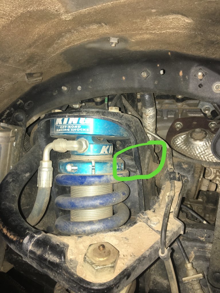

    Don't cut that. Taco coil buckets are weak to begin with. Pb blaster the threads and lift the wheel off the ground.

    The issue is I can't get a fucking coil nut wrench in there cuz there's no fucking space and the resi hose is in the way on the other side. I got one full turn and now I can't get it to go anywhere else.

    The harbor freight ones work fine

    Just pull the coil over out if you really can't get it. :notsure: don't cut the bucket!

    Just take the resi hose off it's not like you're going fast enough to use it :D :boink:

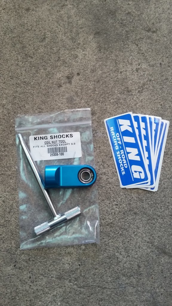

    That's what I use and a home made cheater bar :thumbsup: Worked fine on @itaro Kings and he has 700 lbs springs.

    Think you are going to need to use a punch. Just make sure there is lube and no weight on the CO.
    Something to help loosen the threads. Just wash the truck after.

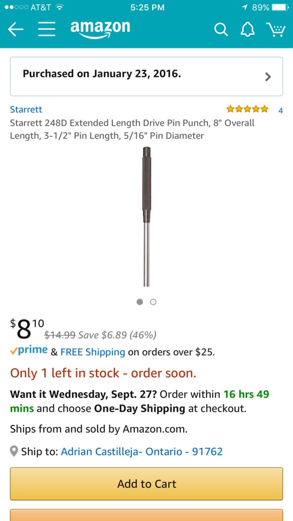

    Yup I used a 5/16" punch grinded down to the size of the hole in the King coilovers. Worked better and cheaper IMO. $8 for the full set....can't beat that!
