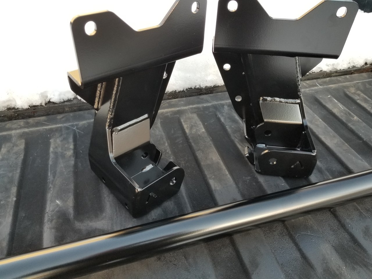

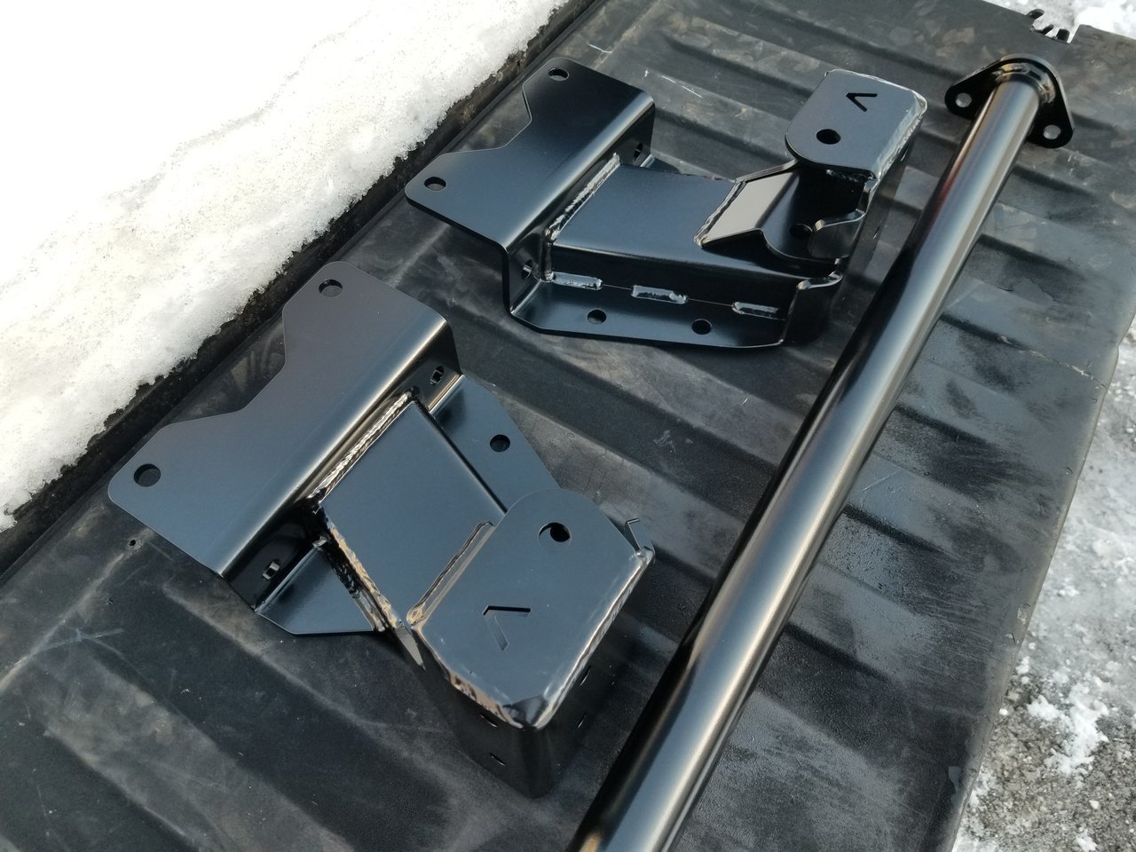

    I think not knowing is a good reason to dig in and ask why, not blindly decide against something. Basikbiker also knows that moving them back is better, he set up Nick Delucas truck, and tried to tell them.
    Maxx Powell has the Hammer hangers installed and noticed the ride improvement. He also checked droop with shocks unbolted, and said he was impressed, needs longer brake lines to.

    That's fair. I recommended something I'm familiar with, not what I've researched. I was fully onboard until I learned about the change in suspension geometry. I do have a couple questions to become more informed on the benefits of your product. Hopefully this will help Sandz as well.
    Here you state improved bump and droop. I understand with the addition of the shock relocation and the new hanger you could have improved droop travel. How does your hanger provide improved bump travel?
    Please correct me if I'm wrong here, but the leaf springs most of us are using (Deaver, OME Dakars, All Pro) are designed with stock front and rear mounting locations, correct?
    By relocating the pivot point how does this yield better suspension travel over the stock location?

    Mike, thanks for looking into it, and asking for explanation. I do think the Hammer hangers will droop better than my shackle flip, and definitely have better bump travel than flip (shackle flip increases negative arch at full bump over stock hangers).
    I know the HH will droop better than stock, here's why. Most spring over packs fully arched up are longer eye to eye than the distance between the front hanger bolt and the rear shackle bolt (when horizontally laid out).
    The springs won't fit down in with stock shackle hanger pivot location.
    Now take a look at all the designed SUA kits (DMZ Giant), full droop happens with shackle fully laid out.
    Archive is first and only to try to do the same for spring over packs. Some of the expo packs may still have trouble getting shackle to lay out, but i know it will be better than stock location for sure.
    Besides that, the stock hangers are the worst part Toyota ever made, they are so flimsy they introduce chatter into the rear suspension and give it that signature Tacoma twerk. Like a spring attached to a spring! It's partially why a TRDPro can't hang with a ZR2, the rear end gets so upset. It's not the frame, springs or shocks, it's the hangers.
