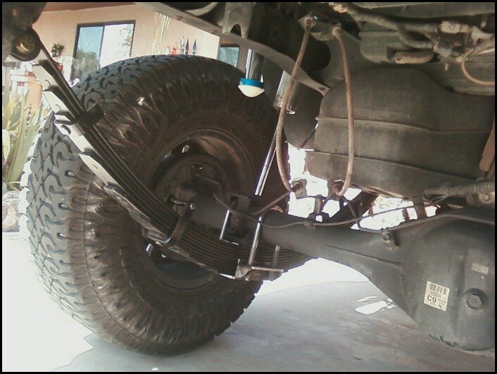

    SUA = Spring Under Axle
    SOA = Spring Over Axle (stock config for off-road and sport 6 lug tacos)

    Spring Under Axle

    With your leaf springs under the axle, they do hang lower and you run the risk of them getting hung up on a rock, but you gain more uptravel.

    Just wheel right and let the tire go over the obstacle instead of around it and you will be good!

    That was what i was gonna ask you..Will the clearance be the same

    Nope. But like @Coot83 said, run your tire up and over or a bit further around a rock to avoid hanging up on it. The ubolt plates for sua are also really stout so you could slide on them if needed just not ideal.

    Yep that's exactly what I do...They do typically design the bottom plates as mini skid plates in a sense with a decent front lip to them. Just make sure you trim up your bolts after you install them as they can be a little long.

    It looks crazy haha

    There is so much lift it looks like i could lay down n camp out in that wheel well, more flex is always nice though. Cant say im not trying to do the same

    Hahaha it looks more normal/level at ride height. You can droop them down really low as well, but that up travel is the main advantage!

    :facepalm: Didnt see the floor jack haha

    I could see a use
    For this in sand.
    Other than that worthless. I would be afraid to take it anywhere else. For reasons stated above^.
