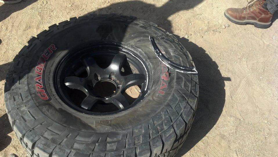

    How old and how many miles are on those?

    Wow. That's crazy! Every wheel is cracked. Could've been catastrophic
    Checking mine this weekend. Thanks. Sorry all of yours failed.

    Not to stir the pot, but did you post in the FN thread? I mean, this could be a major defect.

    late 2008 early 2009. 2 of the all black ones are blems from those guys, they offered me a discounted price to replace the first 2 that cracked.

    Edit: to make clear, the replacement rims have also cracked and are shown above

    I have posted several time recently, and also in the past. An email and PM has never been replied back to.

    And then theres this one..

    Many years ago the FN dude met me late at night in a In N Out parking lot just to make the exchange to replace the first cracked wheel. That was great, and was the reason why I didnt realy say much. I picked up the second and 3rd wheels at their office without any issues either. The all bronze wheel above was a loaner..

    They're like your old duratracs, kept getting replaced so kept with them... until now.
    @MonkeyProof do you feel it's a casting issue? Or you're wheeling harder than the 2,200 lb load rating can handle?
