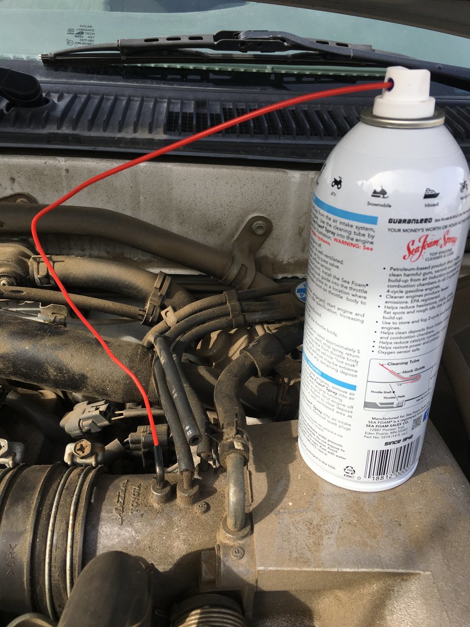

    I only have the spray not the liquid. Is that ok?

    The spray use the smaller tubes to the left on the tb.

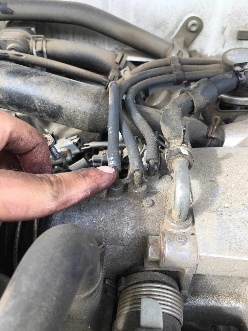

    Thanks. These right?

    Yup just one of those. Might throw a cel. It's mellow. The spray tube fits nice in there.

    Ok. So pretty much stuff the red tube in one of those. And spray the whole bottle while the truck is running? I already cleaned the maf too.

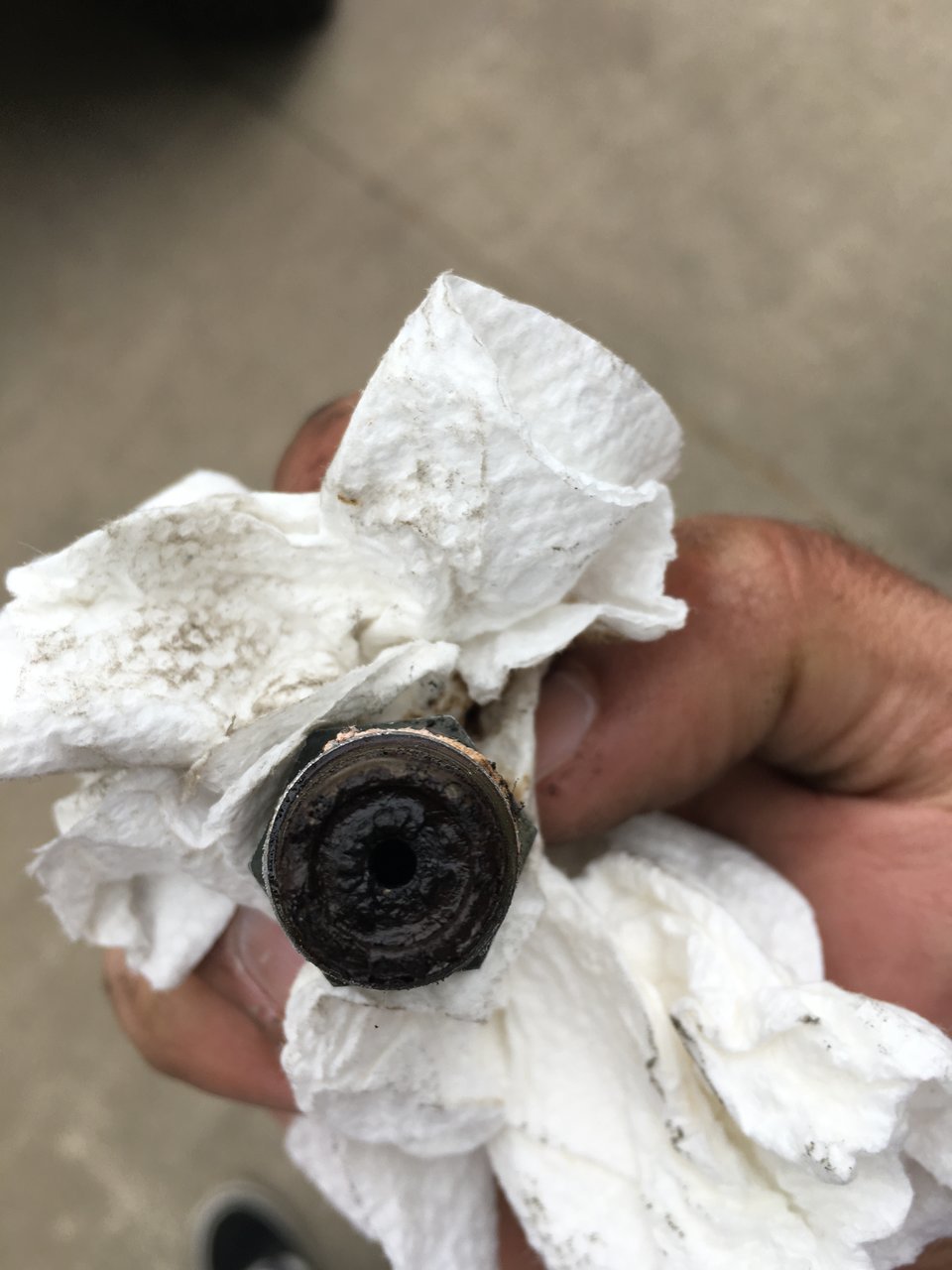

    Working on replacing this guy now. Then the valve cover, and spark plugs. The gap
    Is .44 right?
    The old PCV was dirrrttty.
