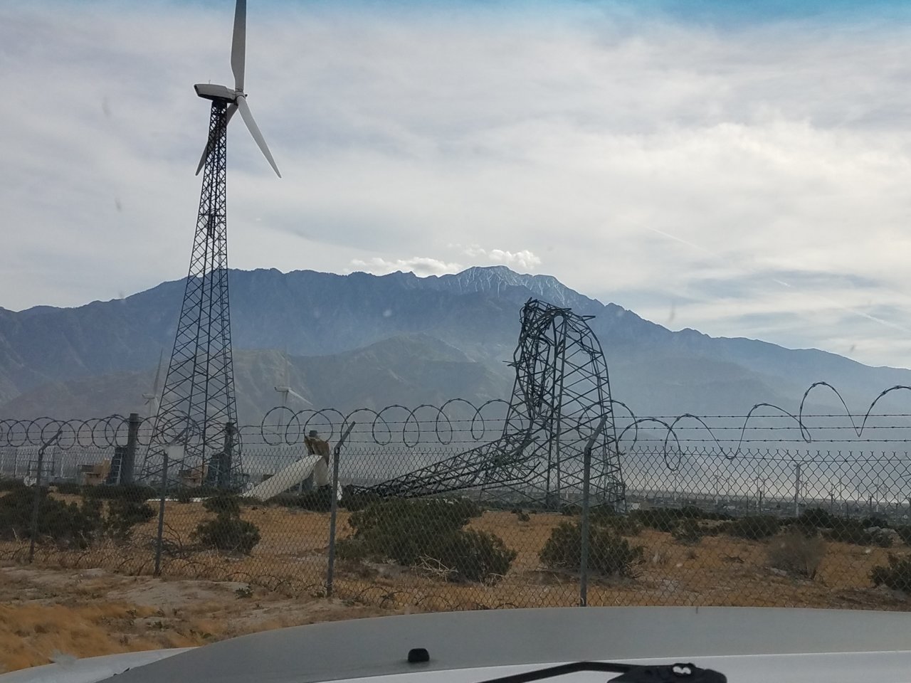

    Another ones bits the dust. Most likely a runaway and self destructed.

    Hahaha ya pretty close! There's all kinds vids on the net. Type in "turbine catastrophic failur".

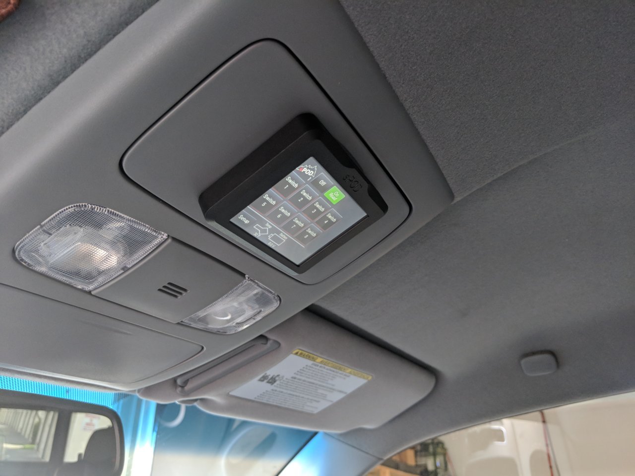

    Well fuck me. Spent a good portion of today installing the sPod and of course there is an issue.
    First off it is a total bitch to get a cable with an RJ45 end on it through the grommet that the main wiring harness goes through. I finally did get it though but in the process I think I damaged the cable or the cable was already damaged.
    The touchscreen powers on but it flickers a bit, doesn't show battery voltage or sPod temp, or actually activate the switches.
    So to troubleshoot I unmounted the touch screen from where I had it and took a standard Ethernet cable and plugged it into the source and sure enough it worked just fine.
    Im done fucking with it for the day but I guess tomorrow I will cut the ends off the current cable, pull a new cable with some CAT6 I have in the garage and then terminate the ends.
    In retrospect I should have just used the CAT6 cable I had in the first place.

    Yeah now that I know its just CAT5/6 with standard pinout makes it a lot easier.
    I did cut the boot some to get it through.

    And I just couldn't let it go till tomorrow.
    Pulled a new cable which is so much easier when you can use the old one as a pull cable. Didn't have to drop the headliner this time.
    LET THERE BE LIGHT
