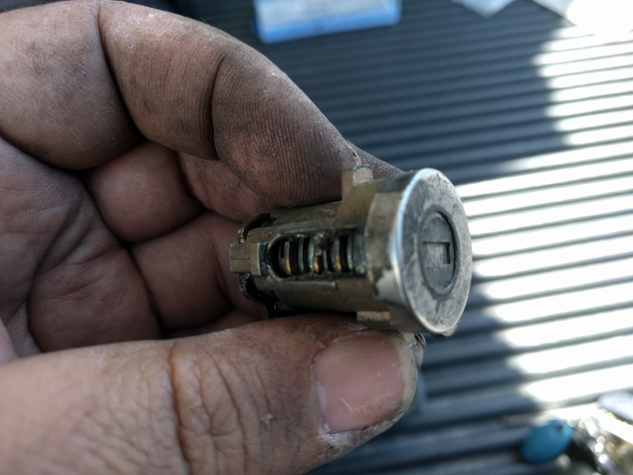

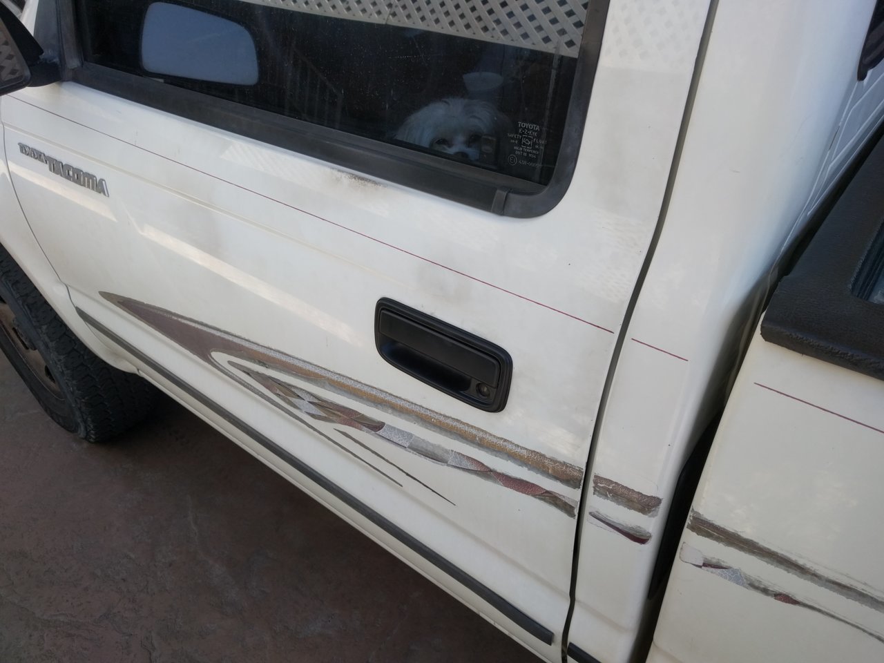

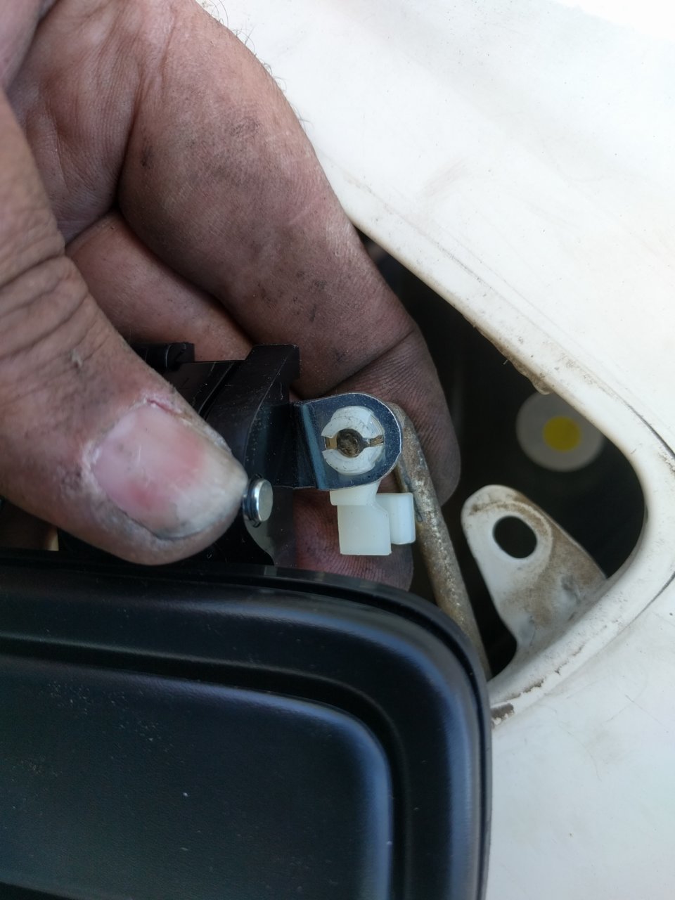

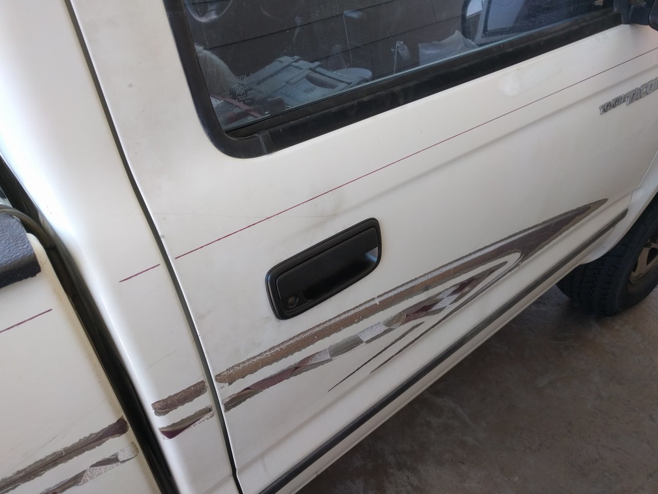

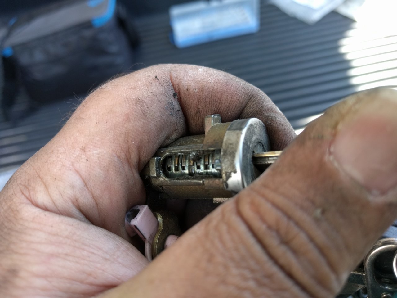

    @MadTaco461 and @dtaco06 I have both new door handles installed!!! :thumbsup:
    old driver-side handle:
    old passenger-side handle (broken):
    When working on the door handle, it was easier to remove the metal window guide. Also, to unlatch the plastic "latch" that connects to the linkages, it was easier to disconnect by taking out the 3x screws for the door latch itself and then bring out the whole door handle and linkage assembly out more to where it makes it easier to deal with. :thumbsup: Then use a screw driver to slightly "pry open" the plastic just enough to slip the linkage end through the plastic clip. (see pics below):
    The key/tumbler assembly:
    NOTE: it looks okay??? A bit gritty, but okay, from I could tell??? :confused: After installing the new handle, I didn't reconnect the plastic latch to the linkage because I'm gonna take this key/tumbler out again and give it a good bath. I couldn't do it here at my brother in-laws place because the guy doesn't have SHI* as far as tools and other much needed guy things???!!! :annoyed: Me personally, I'd go F'N NUTS if I didn't have tools!!! :thumbsup:
    Here is the same tumbler assembly, but with the key in it to try to show that it only turns so far???!!! I can clearly see the tumblers "flatten out" when inserting the key, but it just stops at a certain point when turning the key??? :confused::goingcrazy:o_O:annoyed::frusty: NOTE: passenger-side key/tumbler works with no flaw whatsoever??? The driver-side just eventually stopped working altogether???!!! :notsure:
    Anyways here are the new door handles installed, reconnected, and tested. The only exception, again, I didn't reconnect the plastic clip to the linkage for the key/tumbler assembly on the driver-side. Easy enough to remove it without doing much else. Gonna bathe that bastard for sure and see if there is "dirt particles keeping it from completely turning??? Other than that, it looks to be working fine???
