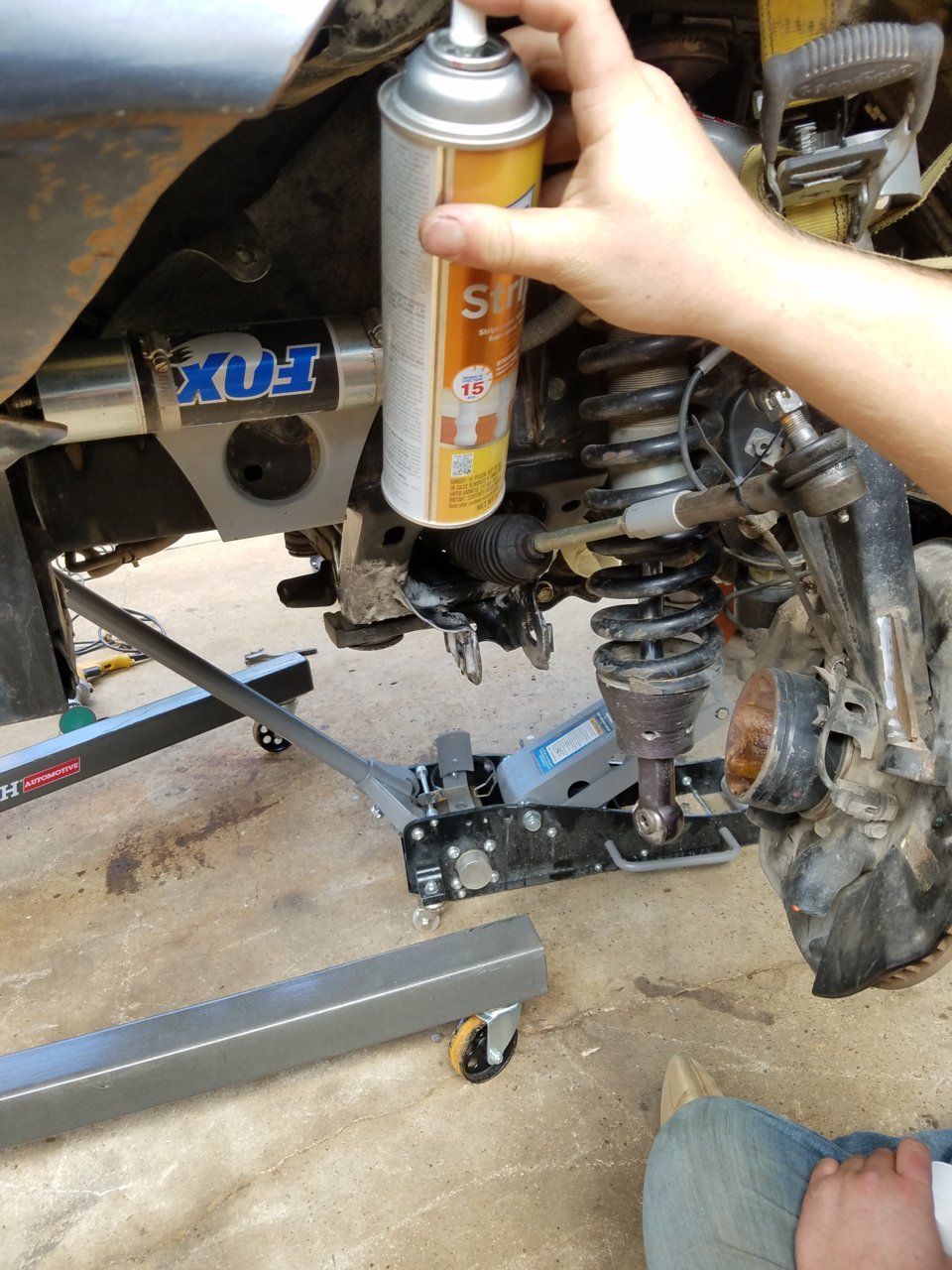

    So after you've seen and installed them, any things you wish you had done or not done during the install? Or anything I need to watch out for that could be fucked up? I doubt those things come with any kind of instructions.

    Paint remover is essential for prep, behind the rear mount is just to funny for wire brushes or whatever you think might work. We wasted time figuring that out. Waiting for the paint remover to do it's thing took time too. other than that, the install was a breeze, each piece fit great. I opted for the precut version without the bends. There were no issues forming each piece, tac and bang to form with a small ball point hammer and repeat. Make sure to put a bead inside the LCA's as well.
    Edit: it was like putting a jigsaw puzzle together since no instructions were included lmao
    2nd edit: might as well change out the LCA bushings since the arms need to be removed anyways. I thought mine were good to go, but of course there was one side that should be replaced.

    What kind of chemical paint remover did you use? I was thinking about starting to use it to get to those shitty to get to areas I've come across several time.

    this stuff..but they stretching the truth saying 15 minutes, also burns on contact :p
