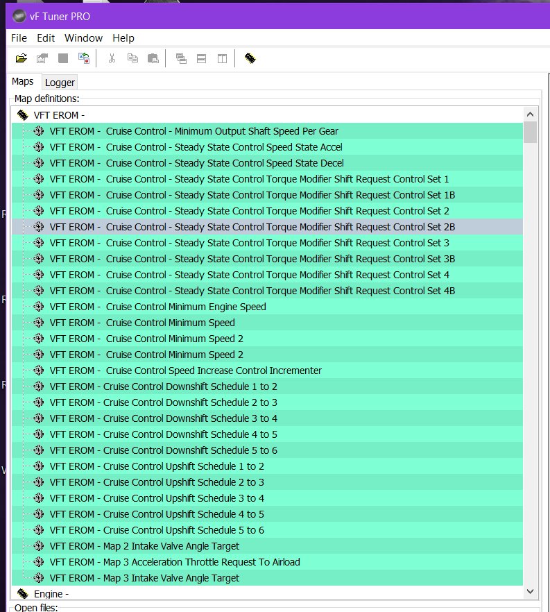

    I have had people with radar cruise tell me that with the tune it is better. But I don’t have a setting in Vftuner to change radar cruise settings.
    This is all I got in Vftuner.

    Wonder if you'd have the ability if you would UPDATE vF! :rofl:
  8. Mar 27, 2021 at 11:37 PM
    #288
    PapaRee
    PapaRee Pro Tuner
    Oct 31, 2015
    #168275
    3,250
    Kreg
    Prairieville, Louisiana
    2016 Black TRD Sport, Tuned, BHLM OEM LEDs
    GTS Dobinson's lift, 33"-Wildpeak Atw3-18x9 -6 Offset ,265/70/18 tires, Raceline Assault wheels, Backflip G2 bed cover, Magnaflow exhaust, Pro tail lights, Pro fog lights, Pro grille, Raptor grille lights, Predator side steps, RedLine Hood Struts, Toyota bedmat, tinted windows, Retrofitted-BHLM-Amber Halo-Amber DRL-HID headlights, LED Highbeams, LED Hood Scoop lightbar, LED hidden bumper lightbar, LED under hood light, LED Bed lights, LED license plate lights, Tacoma tailgate 3d letters, Tacoma glovebox 3D letters, removed air dam, Custom TRD Sport emblems, Pro Shift Knob with Meso ECT Stealth button, Meso LED dome and map lights, Meso V3 smoked mirror turn signals, Meso Stage 2 Tail lights, Meso Mirror Puddle lights, Meso KC-5 Brake/Cargo light, Meso center console bucket with OG lid, Tailgate PNP kit, Garage door opener button in overhead console, Meso Minimalist keyfobs, Matte black Pro hood decal, KTJO4x4 Led door handle LED lights, Pioneer 6x9 3 way front speakers, Rockford Fosgate 6.75' rear speakers, TacoTunes tweeters, AJT black vent rings, JDM Gas cap cover.
    I just edited my post above. That is the most up to date VFtuner Pro version.

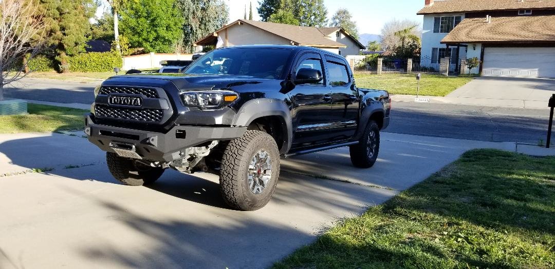

    Early travel to Loma Linda to get Nick @npcrs ECU updated and flashed KDMAX performance tune! Another MT tuned!

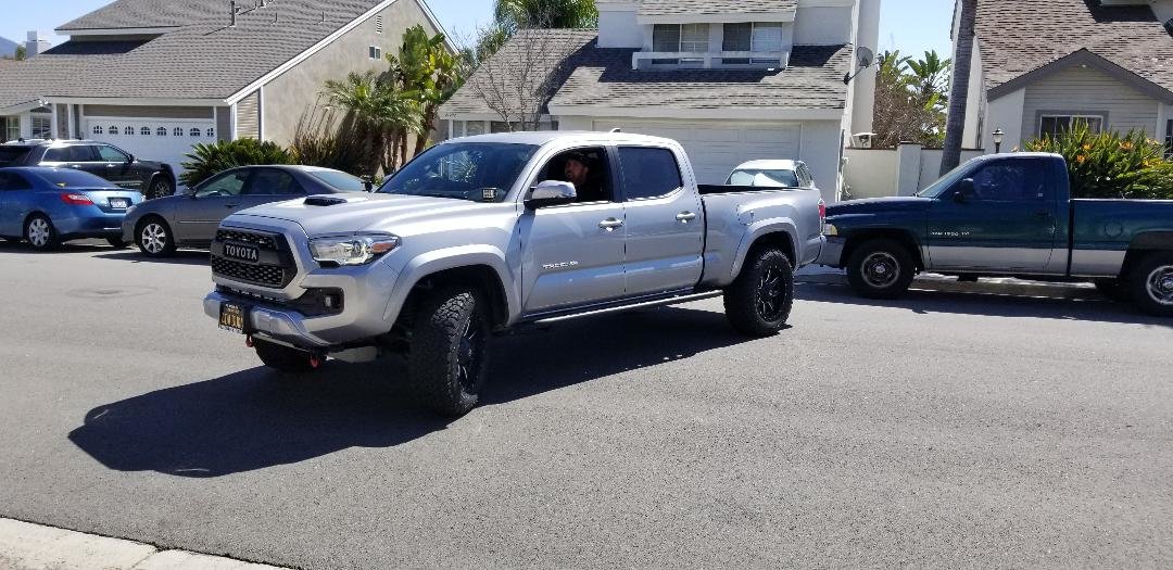

    Jeff came by at 11 this morning to update his ECU and flash The KDMAX performance tune!
    Nice talking with you this morning and meeting your dog Derby a Blue Heeler! Sorry didn't get Derby's picture!
