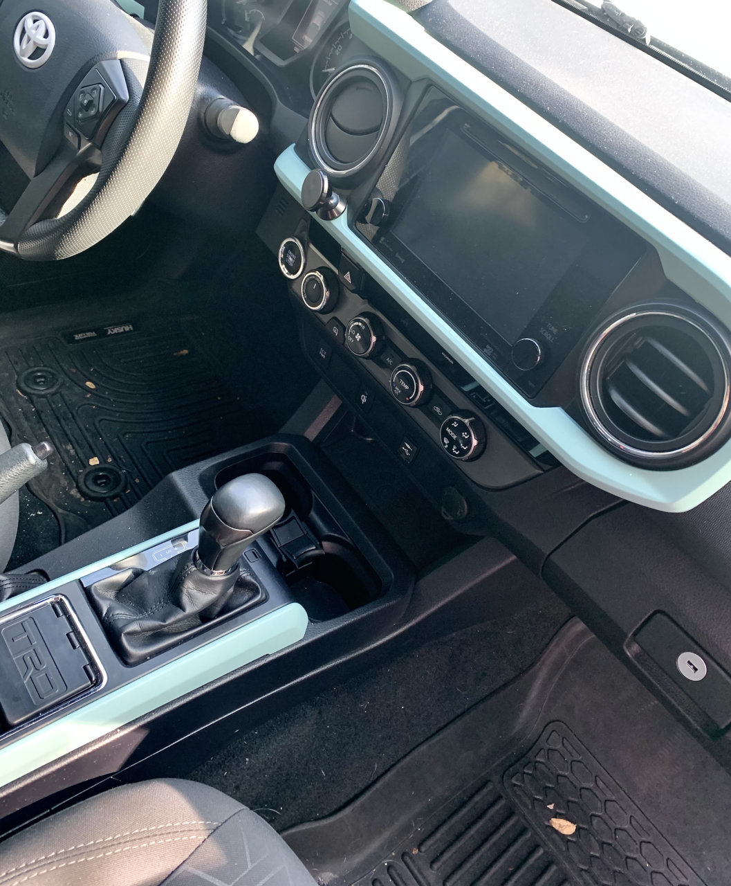

    I removed and painted mine the color I wanted. It wasn't difficult, just a little time consuming. Go for it.

    Krylon 2X paint/primer matte finish, 3 coats (Coastal Sage color). Did all the trim including the back doors. It has been about a year and has held up very well. No significant scratches.

    The console pieces just pull off (piece around touch screen first then piece around instrument cluster) but the trim you want to paint is held on by small screws. Very easily accessible. On the doors, I just unplugged and removed the whole piece and taped off everything but the trim.
