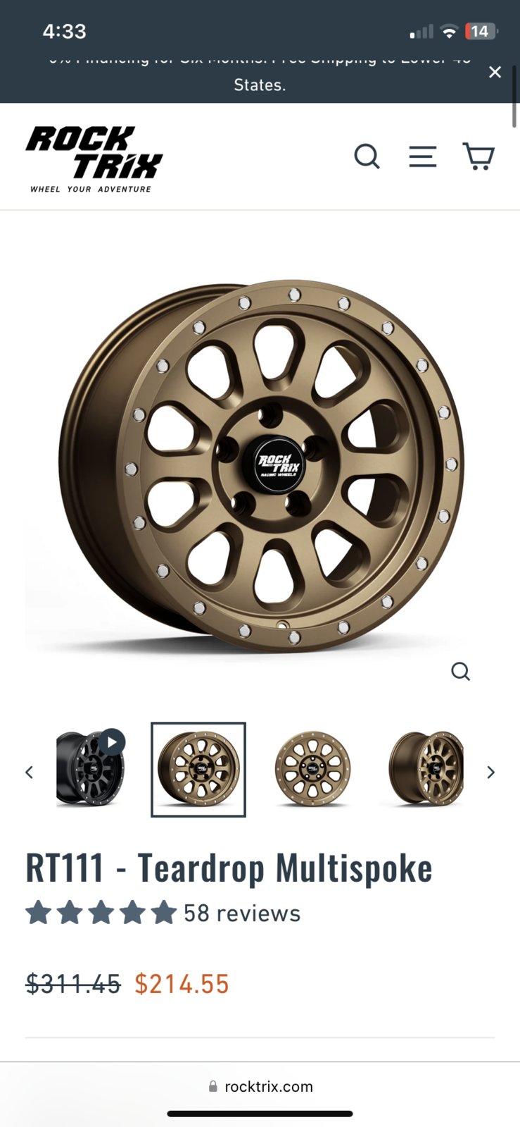

    ordered 9 inch wide rims but most LT tires are suited for max 8.5 rims??? is it possible to put a 9 inch on? will i run into problems, will it look weird? is it safe?

  6. Jul 9, 2024 at 6:45 PM
    crashngiggles
    crashngiggles Tacomaworld's Resident Psych Dr.
    May 17, 2015
    #155446
    7,459
    Jared
    Wilbraham, Massachusetts
    2013 MGM TRD 4x4 DCLB Trail Limo
    You did not make a mistake.at all with the Rocktrix wheels, the only tire that will.not.fit onto it is a skinny "pizza cutter" type tire that is smaller than a 33". Any 265/70/17, 275/70/17, 285/70/17 or bigger will fit. A tire like a 245/80/17 will not.

  7. Jul 9, 2024 at 6:46 PM
    mark06yoda
    mark06yoda [OP] Well-Known Member
    Dec 12, 2023
    #439394
    165
    marcus
    2006 Black Tacoma TRD Sport DCSB MT
    yes yes okay so maybe i keep the rims for now get tires and a lift slowly and see what happens from there

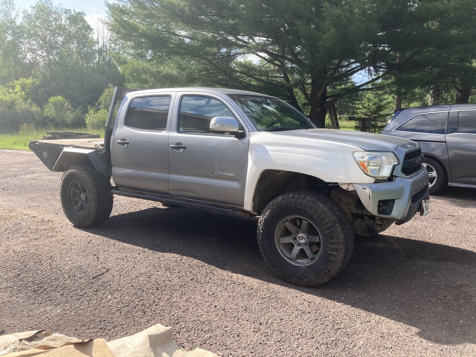

  12. Jul 29, 2024 at 3:18 PM
    RockTrixWheels
    RockTrixWheels Well-Known Member
    Jun 6, 2024
    #451027
    52
    2018 Cement Tacoma TRD Pro
  13. Jul 29, 2024 at 3:40 PM
    TacoTuesday1
    TacoTuesday1 Well-Known Member
    Jun 19, 2019
    #296781
    7,751
    FL
    why LT
    rim width is dictated by tire width not load rating
    that being said I’ve been told 9>8.5 which is kind of making me regret my 8.5
    Not to mention the offset on 9 looks better removing the extra purchase of spacers after
