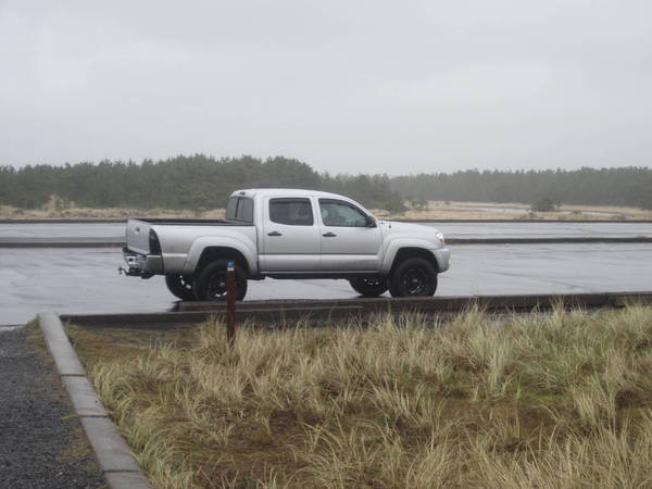

    I have 2.5'' up front with tsb and 1.5'' aal. heres a pic. I think 2'' aal will be good for you if your not going to get the tsb done.

    Just a tad higher in the rear.
