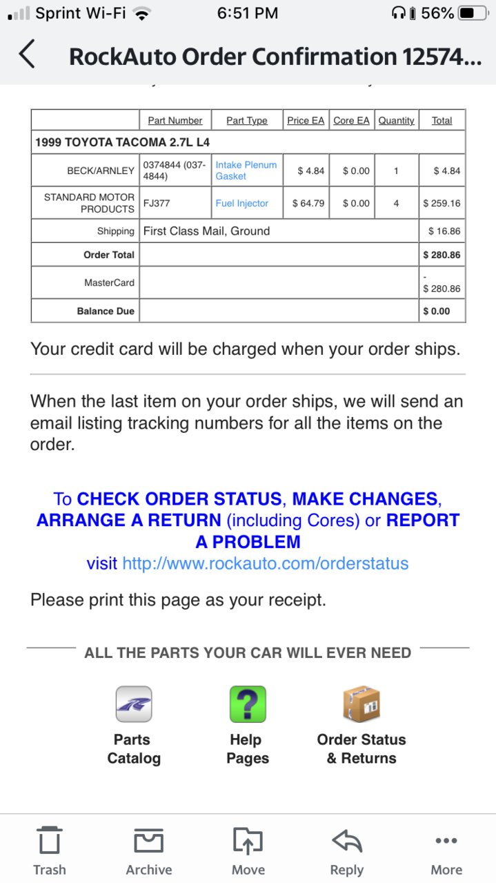

    Shudders under light load, won’t outrun Meatloaf on a scooter. My LTFT has been running +10-14, two known good O2 sensors verify it. New fuel pump, filter, maf. Absolutely no vacuum leaks. Nearly 200k and I’m unsure if they have ever been replaced. Please encourage me that I didn’t just blow 280 bucks.... :anonymous:407B5A45-50E9-4244-B08F-1731AB501C4A.jpg

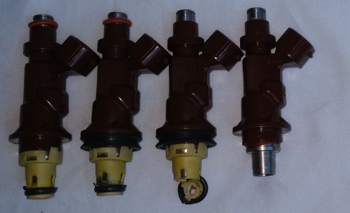

    Be sure to post pictures of your new compared to old. Your current injectors are brown tops. Right?
    Without anybody seeing your truck, I haven't seen a definitive "silver bullet" answer. Whatever the issue, you will be the one to find it.
    I've been very happy with the new FJ585s from Rock Auto that I installed a few weeks ago on my 3.4L. It just runs a little better than before. Nothing earth shattering, just a little more responsive.
    Roughly 10 years ago, before I discovered Rock Auto, I bought a set of SMP/BWD Intermotor injectors from O'Reilly for an 8 cylinder at $125 each.
    That was over $1,000 with tax. It was expensive, but they still perform great after all these years. No regrets.
    Here's what happens to counterfeit OEM injectors from Amazon. The pentile caps start to melt and deform. One melted, deformed, and became stuck in intake manifold. The top o-ring started leaking fuel all over the engine. This is what cheap garbage from China looks like after 1,500 miles.

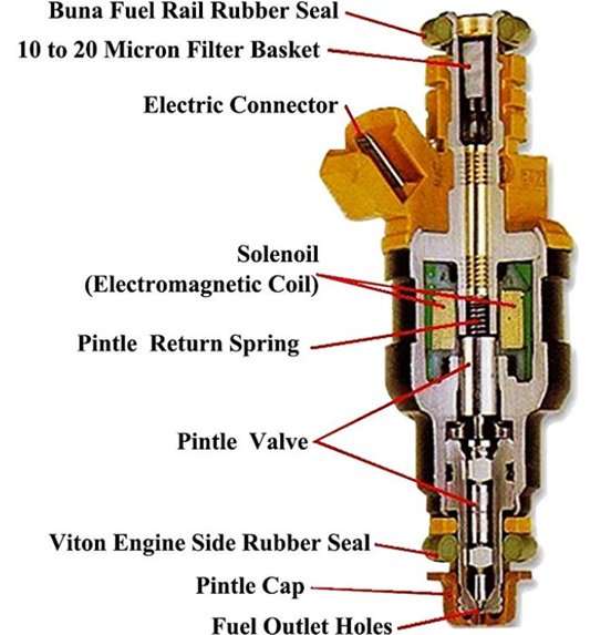

    I've witnessed and personally experienced an increased likelihood of coil failures on injectors over 20 years old with 200,000+ miles. As you can see from the diagram, there are electromagnetic parts inside a sealed injector unit. Sure, these can be cleaned. But there is no process for opening a sealed injector unit to replace the coil, spring, and valve parts.

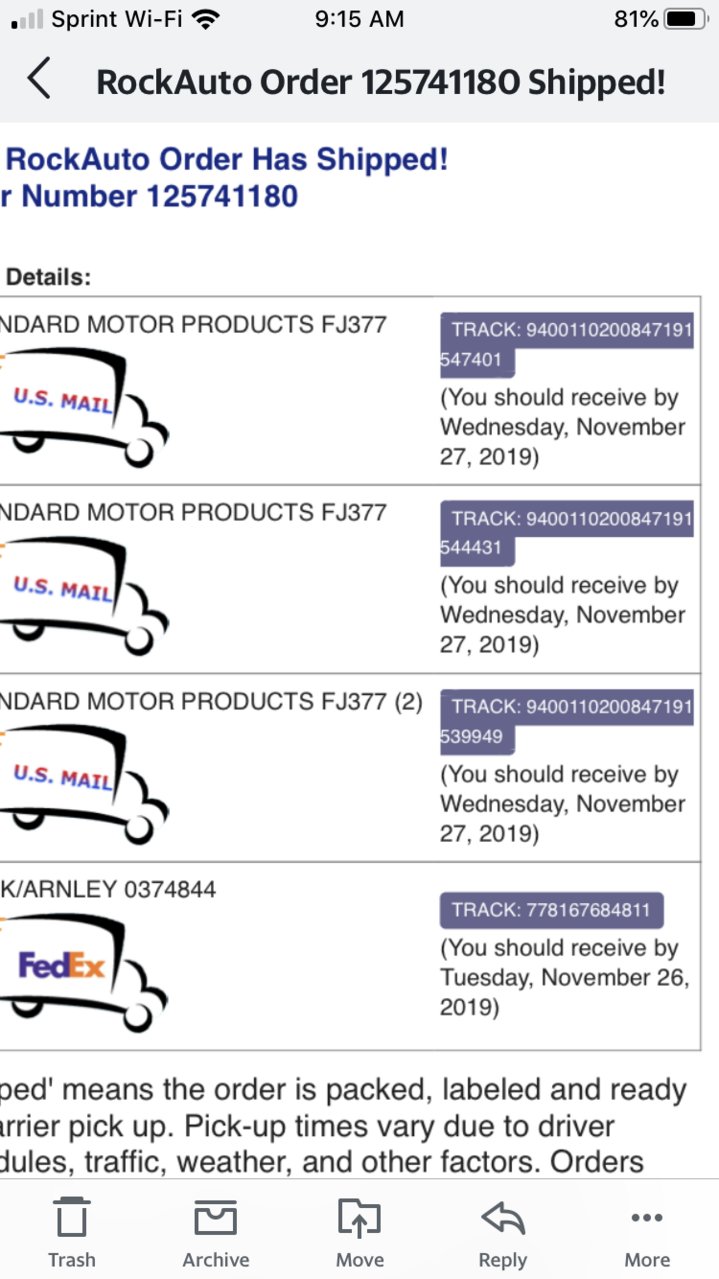

    Yeah, the Intermotors from RockAuto were 70 bucks each; interestingly enough, they are being shipped from 3 different locations. You would think there would be a dozen of these things at each warehouse. The Plenum gasket is coming from yet a different place. Another reason I suspect this is my problem is that the truck was in storage for two years, who knows what the ethanol did while trapped in the injectors it hasn’t been right since I’ve owned it.A1E7C6DF-341D-454B-8F27-557A47AD620E.jpg
