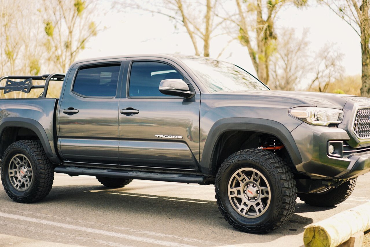

    Update: got just about 3” in the front and about 2” in the rear. So far so good with the ride. Just had about 40-50 miles with mixed freeway and in town. The biggest thing I notice is the front doesn’t dip when stopping or slowing for corners.
    Glad I went with the JBA UCAs. Needle bearing swap went good and my needle bearing was already showing wear at 7k miles in!
    Went with icon Aal pack and took out stock overloads. So far so good. I got a few teardrop trailers and the jack stands would barely scrape pre-lift and I’m interested to see if I notice any ride and/or backing in difference with the new kit.
    I’ll add alignment specs once I add pics too. Then I can debate if I want to stay with these tires or not. Haha

    Shoot. 4th clip and the spacer on driver side. (2nd gen bilsteins on my 3rd gen)

    AEACDB5F-2A6D-4EDC-BA2B-2B631C7D53C1.jpg 7D06CD49-95FD-4E3E-8017-A34402B47DB1.jpg
    I’m happy with how it sits, and it’ll be interesting to see what happens when it settles. I might go to a 275/70/17 C instead of these 265/70/17 E. I don’t think the tires look bad though!
    MtnFisher, YEMTaco and oscolivar1 like this.
