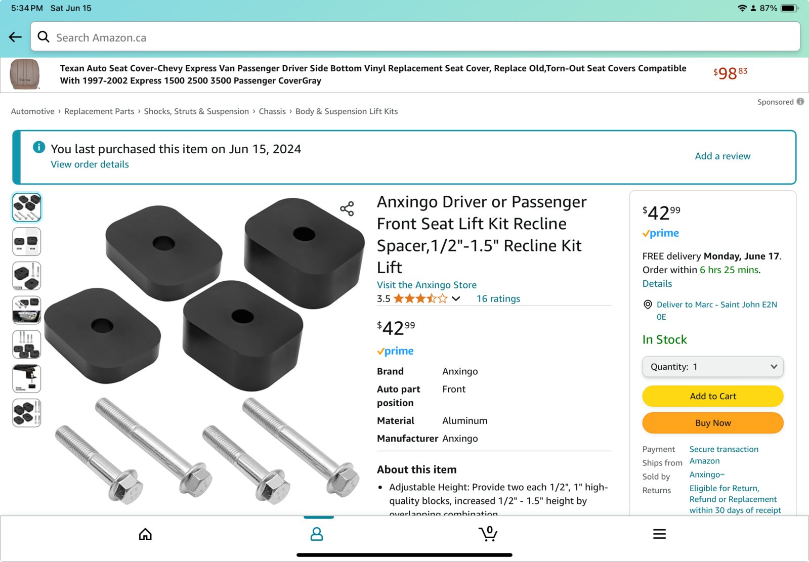

    I have a TRD Offroad with the manual seat, so there's no tilt adjustment like the power seats. I find the front of the seat too high in relation to the rear for my 55 year old legs with circulation problems. I'll lift the back a bit.

    Installed them and they work great if you want the back of the seat a little higher.

    Still happy with these? Seats are killing me behind the knees....

    Yes very. Installed on driver and passenger side.
    For an easy test, unbolt the 2 rear bolts, put a 1.5" piece of wood under both legs and sit on the seat and see how it feels, but not for a drive. If you like the feel, order a kit.
