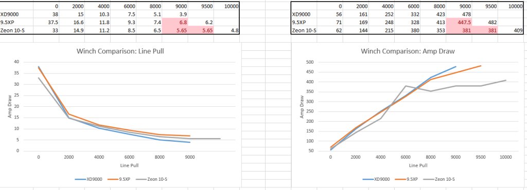

    Well, I spent about the last 2.5 hours mucking about trying to find comparisons (holy crap I should stop!), and I can't find a ton factual. This is what I've come up with (I included the 9.5XP simply because that's what I have and I just wanted to see)
    • Rated pull: Well, this is obvious. It's in the name
    • Gear ratio: The Zeon has a higher gear ratio. It's going to pull stronger, but slower. This isn't bad because the 9.5XP was regarded as almost too fast of a winch. Slower winches can sometimes be safer and easier to manage, just as long as they aren't ridiculously slow.
    • motor: I don't know the size of the zeon, which is frustrating. The 9.5XP is 6HP, which explains why it beats the XD9000's smaller 4.6hp.
    • Clutch: zeon uses a rotating ring gear. The others use a sliding ring gear. I don't know what this is, hopefully somebody can chime in.
    • drum diameter: the zeon is .5" wider. This might help disperse heat?? Maybe helps with strength?? I don't think it matters since the 9.5XP was one of their top winches in the past
    • Power draw: this was kind of interesting, it seems the zeon does the best job at really tough or really light pulls, but spikes bigtime around 6k lbs. The other two are pretty linear and power hungry. I'm not an expert, but I'd assume you could say that your average amount of work is going to happen in the middle of those extremes, so the zeon is going to suck more on average in this category
    • Size: the zeon is big but people have been making them fit. The control box can be mounted remote, no more integrated-only styles. Note that I've hacked my control box up pretty good to do custom mounting, so I don't think curvy shapes are all that great.
    • waterproofness: the zeon is the only one that has a an IP rating of 68, which is very advantageous, especially considering WARN doesn't warranty against water getting into the electronics of the motor past the 1 year mark, even on the zeon. The others weren't subjected to an IP rating.
    • Price: just off gowarn.com, I see zeon $1250, 9.5XP $1450, XD9000 $1093. I found the 9.5XP-S (the synthetic version) on Amazon for $1600.
    Based on that little bit, the zeon looks like the winner in terms of price and new tech.
    The only things I still don't like (unless I'm missing something) is their stance on warranty vs. water, and I'm not sure if any of the winches have a 100% load holding brake like a Superwinch.
    WARN was super nice to me when I had my winch repaired (they really look out for search & rescue, military, police, etc.), so I do have a bit of a soft spot for them still.
    Repairs in Clackamas is pretty nice to have as well.
    Note: red text is an estimate since I don't have actual numbers for these values. I just did the average between the last two known values.

    As always, your depth of research and knowledge is astounding!
    Looks like with my bumper, I am limited to 9.5XP, XD9000, or M8000. I really liked the looks and capabilities of the Zeon. I have to be conscious of price also, so it like the XD9K for James.
    Unless somebody has one they need to sell, or possibly trade for a headache rack?? :rolleyes:
