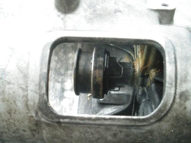

    The clutch fork might not be aligned right. Take the side cover off by the slave cylinder and have a look in there.

    I didn't... I just pushed it to the side. Nothing was disconnected so I shouldn't have to bleed it. Although it felt like the clutch pushed back a lot slower but that may be because I've been driving the jeep for two weeks and it has a really springy clutch
    I've heard about that. What am I supposed to be looking for? When I put the side cover on I made sure that it was on the slave cylinder end. I also tested it with the transmission off after I lubed everything and it slid really smooth.
    One guy told me that he thinks it could be clutch chatter not slipping because they don't let you let them out slow :notsure: like I said I haven't fully let the clutch out yet. I didn't want to break something last night.

    Did you surface the flywheel? Or possibly get any oil on it? If you didn't surface the flywheel it will take a while for the new disk to conform to the ridges in the flywheel. It's not the right way to do it, but you can slip the clutch a few times and burn it in. Be careful, too much and it will smoke it. Then you have to start all over. Good luck man

    I did. My dad had smoked my old one pretty bad so it had a slight warp. They took off two passes and I just had a tiny little hotspot left over. No oil on the damn thing I cleaned it like crazy!! I've heard of people slipping them in... not sure I wanna do that. I called LCE and they told me to drive it nice and break it in. I've been driving it all morning and I already feel better about this. The thing is awesome! I feel like I'm driving my moms race car. It shifts like a dream! Just boom next gear! It even downshifts so smooth and fast too.
    The only con is backing up and starting out. When I do normal acceleration (not launching just giving it a little gas) it just lets out super smooth and goes. But when I don't give it gas and just try to let it out slow it chatters... same with reverse. I don't know man, I haven't launched it yet because of the break in period but it feels like it would handle it beautifully.

    No, I just got back from Walla Walla and won't be up that way for a while. My URD stage 3 clutch took some getting used to as well. It's like an on/off button more than a clutch. You can't really slip it very easy, it just bites and goes. Wait to do any full throttle launches till you drive it around town a bit. I bet it will smooth out in half a tank of gas. You can also adjust the pedal to get the engagement point where you like it. I have mine near the top of the pedal stroke for faster shifts, but the danger is as the disk wears it could slip if I don't adjust the play along the way. http://www.customtacos.com/tech.old...6toyrm/06toypdf/06rmsrc/rm2006ta/02900510.pdf

    I adjusted the clutch pedal a little bit. Yeah it wants to bite and go... I used to not give it gas and just let the clutch halfway out all the time to move forward slowly. It's driving me crazy that my truck bounces me down the road when I do that. And Im paranoid that I broke an engine mount now too... My truck feels kinda shaky at idle.
